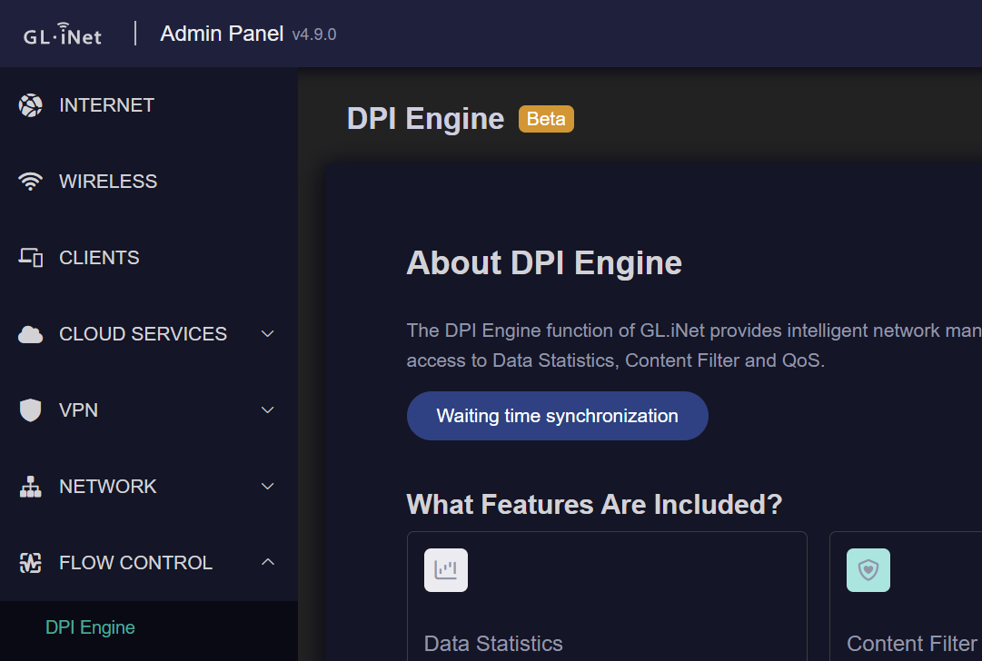

FLINT 2
  • some problem with DPI ENGINE?
    its not clickable…
what should i do?

Please help check whether the NTS (chronyd) service is synchronizing time normally in systhe logs (GL GUI > System -> Log).
Another user reported the same question earlier, there is a temporary workaround, please check
You can also check the time on router and sync it(GL GUI > System -> Time Zone).
