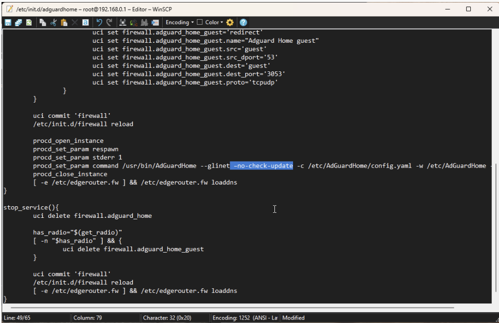

Yes you can! I have v4.8.2 installed on my Flint 2 and when I open the AdGuard Home console, I have the ‘Update’ button. As I did with v4.7.7.
Again, you just need to remove a piece of config from the /etc/init.d/adguardhome file.

I did raise the issue of AGH but I just got a reply why do you want to upgrade it, that’s why I didn’t feel they were looking into it, but anyway yes editing the file works fine if you have a router with limited space just delete the back up files, like previously said I may put back my Flint 2 because Flint 3 hasn’t got a firmware that you can upgrade AGH, I do like the new interface and running different tunnels but there is another issue which I’ve already raised but I’m sure that will be fixed.
