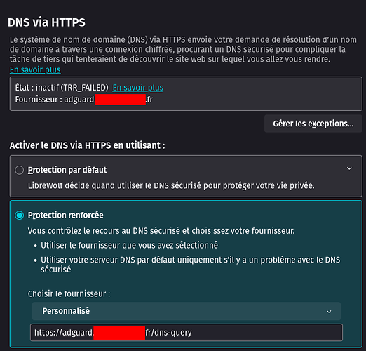

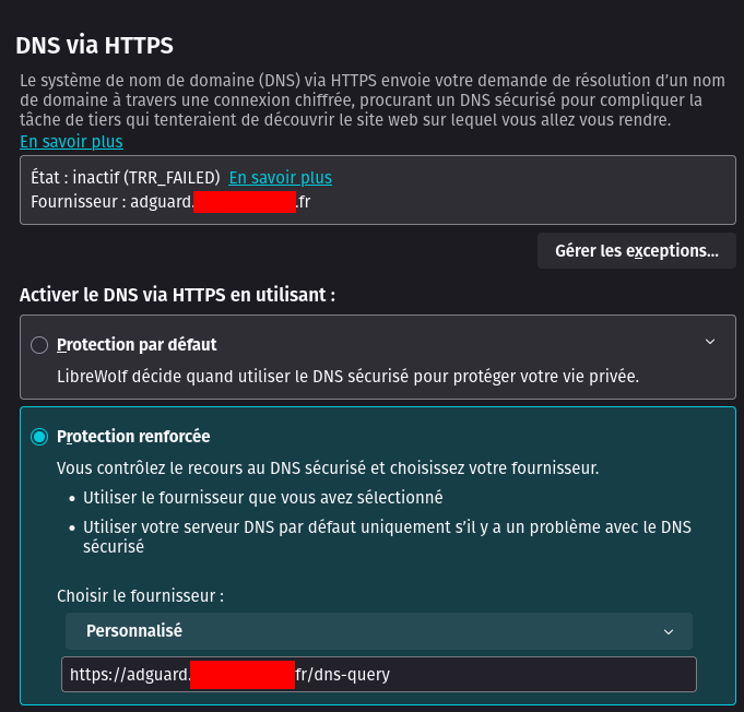

The AdGuard Home seems to be working but the clients that have encrypted dns (tested in 2 android phones) cannot connect to the Internet.

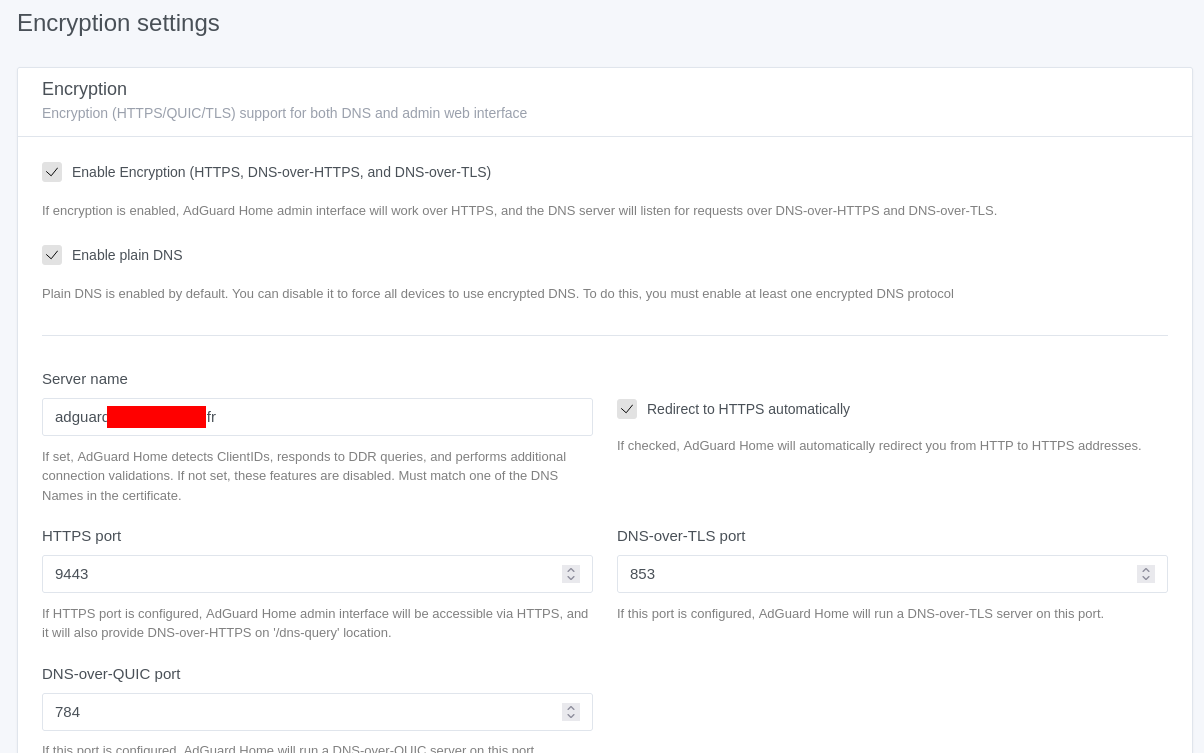

I have enable Encryption (HTTPS/QUIC/TLS), private server with dns over tls port, dns over qui port and with a valid SSL certificate.
I did the downgrade and everything started to working again.
Like the other user said, the DOH and DOT it's not working.
Indeed, Adguard keeps handling “unsecured” request received from LAN and Guest networks. Though encrypted DNS requests that comes from WAN (since I use a letsencrypt certificate) don’t suit anymore to android smartphones or web browsers.

We’ve been able to reproduce the issue on our side and confirmed that it happens when AdGuard Home is used as a DoH/DoT server.

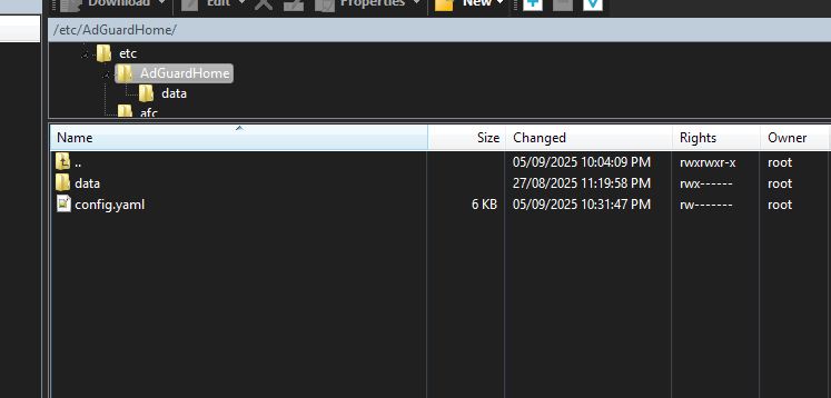

I had a similar issue when updating the device FW to 4.8.2, via the GUI although bizarrely, it looked to be just my TP-Link mesh APs that had dropped connection, despite picking up IP addresses. All wired devices ‘seemed’ to work as expected.
Anyway, I used WinSCP to replace the AdGuard Home files (the files that are usually backed up had disappeared!). Then, and this was the important part, remove the config.yaml file from the device (/etc/AdGuardHome), start the service via the GUI and run through the initial OOTB set up. Once it’s working, turn off the service again and copy the original config.yaml file back across to the device. Start the service up once more and it was now working as normal.

In the meantime, if you would like to continue using firmware 4.8.2 with AdGuard Home, you can try a workaround.
Please try disabling the Encryption (HTTPS/QUIC/TLS) configuration in AdGuard Home and switch your client devices back to the original UDP DNS instead.
