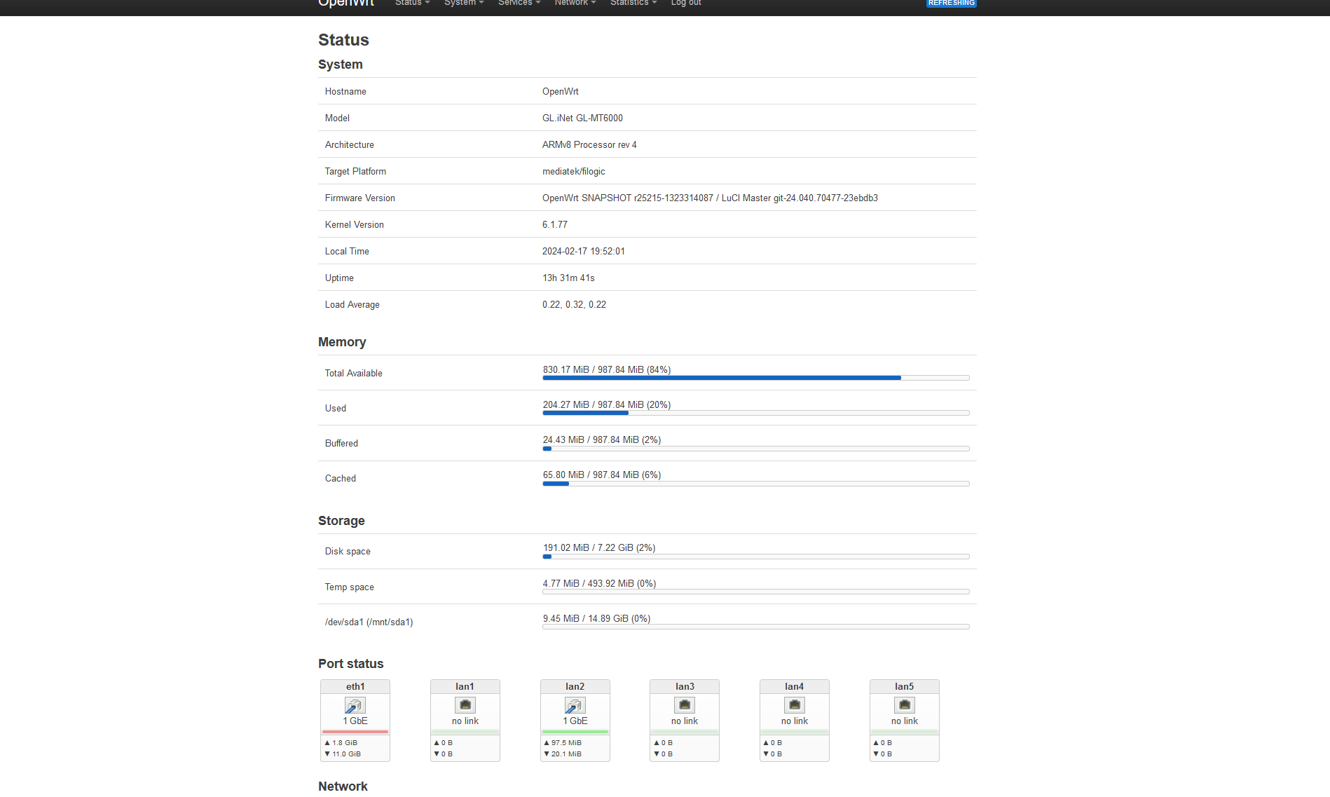

GL-MT6000 OpenWrt has moved to Kernel 6.1.77, gl-mt6000 runs without problems, why not compile for test directly from SNAPSHOT OpenWrt?
@hnyman from openwrt-interesting compilation,I prefer hnyman because he uses all the packages that I use
@ solidus1983 also a good compilation

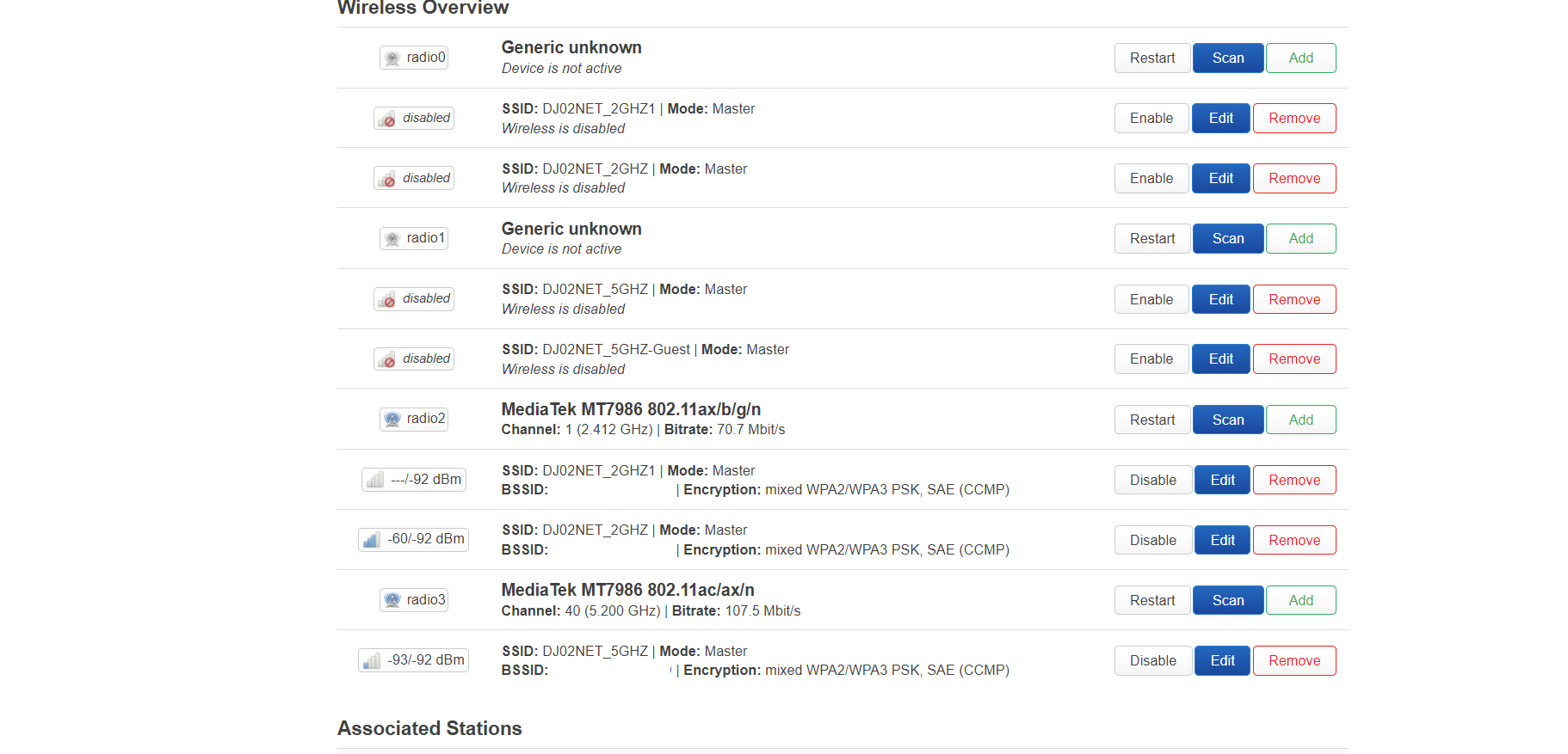

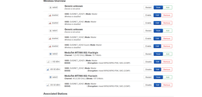

I updated to 4.5.7 without resetting settings, i had to revert back to 4.5.6 (without resetting settings) because ipv6 stopped working.
After reverting back, there is shown wifi radios and ssids double in luci interface and wifi can be only managed via luci. gl-inet interface gives error when i try to manage wireless from gl-inet interface: Unknown error occurred. Please check the network environment or reboot the device.
system log gives error constantly:
daemon.err gl-repeater[16354]: (gl-repeater.lua:245) ./files/lib/repeater-nl80211.lua:378: attempt to concatenate a nil value (local ‘phy’)
daemon.info gl-repeater[16382]: (gl-repeater.lua:259) lua-eco version: 3.2.0
daemon.info gl-repeater[16382]: (gl-repeater.lua: 16) load repeater config…
daemon.info gl-repeater[16382]: (gl-repeater.lua:228) wait ap ready…
Do i need to factory reset or is there some easier way?
Never revert while keeping settings. It’s like a golden rule. It might work, sometimes, but mostly it will break something. 4.5.7 introduced a new Wi-Fi driver.
Just go with an reset.

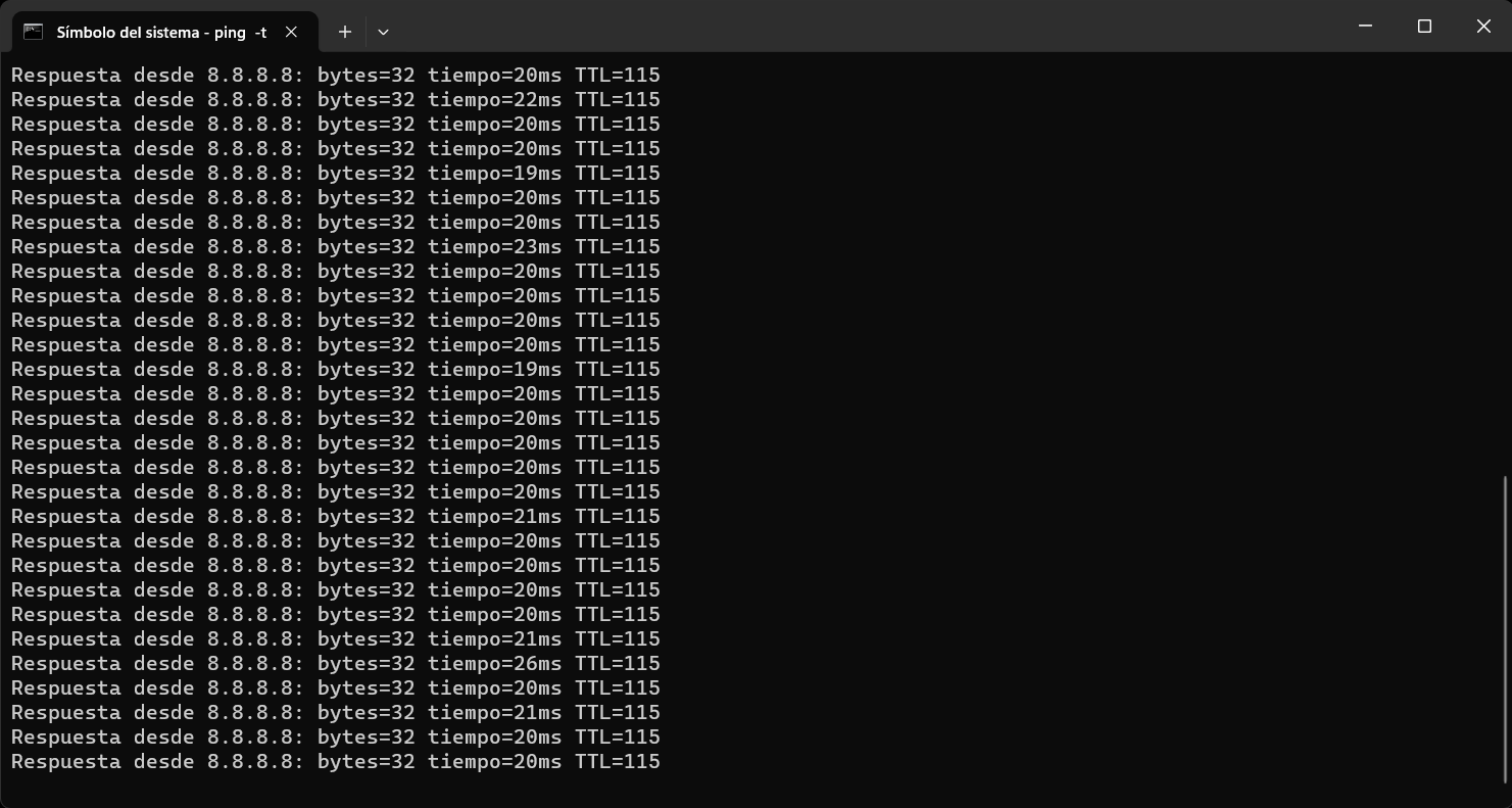

It just happened right now on my computer, I tried to ping 8.8.8.8 and it was successful all the time, but I wasn’t able to load youtube, after 2 minutes it ended up loading, it is like if there was no connection at all.
Maybe this will be useful, here’s the log when this happened @alex_zheng

When you do ping for checking connection, you should do nslookup google.com as well to understand if it’s an DNS issue.
yup I think you are very right on this.
