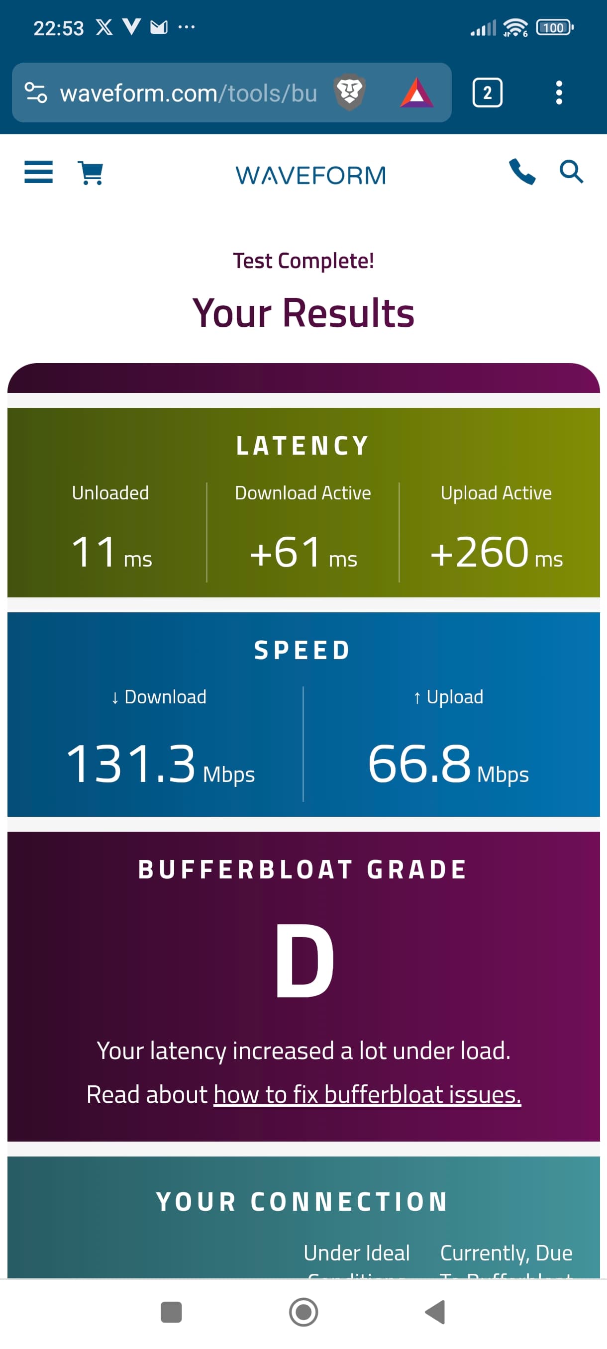

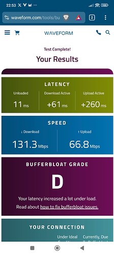

I understand, is the latency still bad? on both networks? Could you do a test for us and post it here?

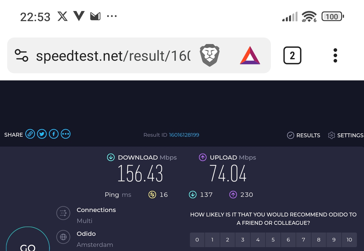

Good question i did a quick check on 2.4ghz (from 5ghz im unaware of issues.)
I got conflicting results:
Speedtest tells me a better ping.
Both tests where in the other room with a plaster wall (maybe 8 meter distance) and my phone pointing to the wireless AP.
I also tried my kitchen scenario, yesterday i was more optimistic until i figured out it failed, this is about 2 rooms and around 15 meter distance.
If i place my phone on the kitchen table pointing away from the router it disconnects from wifi and gets trouble, if i point it to the direction it connects.
This means the issue is still there :+1: ive tested it with dutch country setting.
Device im testing it with is a Poco X6 Pro.
