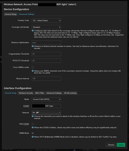

OMG and Jesus christ ive cracked it, ive had to cancel the sale on ebay for the Flint 2, it wasnt until I was setting up the Flint 1 that I discovered what the problem has been all along, quiet obviously a bug in Luci, ive set the Flint 2 back up the same way I set the Flint 1 and it seems to be working fine, its all down to the country code, if I set GB it either wont use the 100+ DFS channels or it will on some firmwares for a short time and then drop off and revert to 40-64, but ive set the country code to the US and time zone to Europe/London and its working fine on 128 DFS 160mhz 5ghz so far 30 mins in, usually its dropped it by now and reverted to a lower channel.

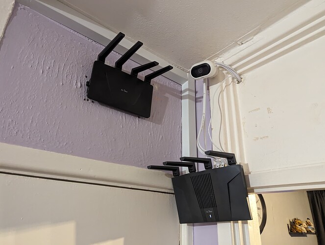

Just a side note: the antennas pointed in that way are ok only if would you like to improve the coverage between the floors.
If would like to improve the coverage on the same floor, put them in vertical position.
You can also put 2 antennas in vertical position and 2 antennas in horizontal position to improve the coverage on both directions.
