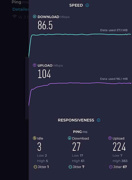

I was testing v4.5.8 and found two relevant bugs:
- Changing the country code has no effect on the maximum signal transmission power. I tested countries like Brazil, China and Germany, all are limited to 20 dBm
- Packet loss in v4.5.8 on the 2.4GHz band is worse when compared to the latest OpenWRT (r25676-2feedab805).
v4.5.8:
Tested in Motorola Edge 30 Neo in 40 MHz frequency
