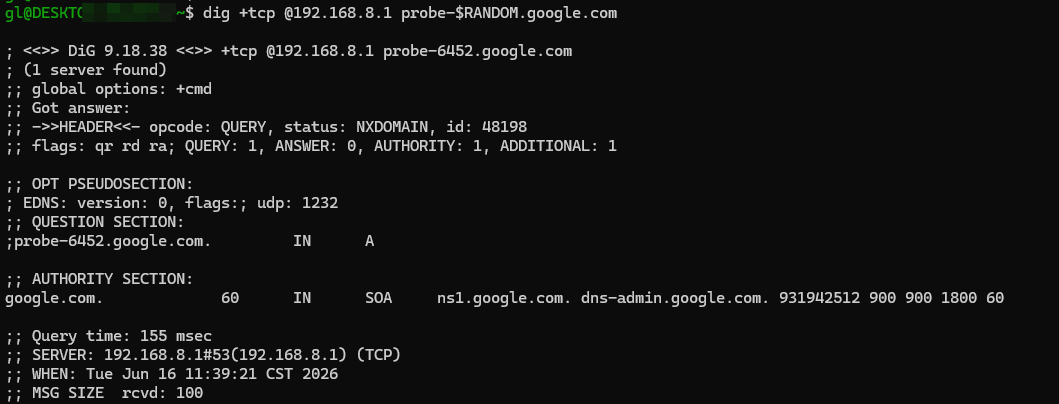

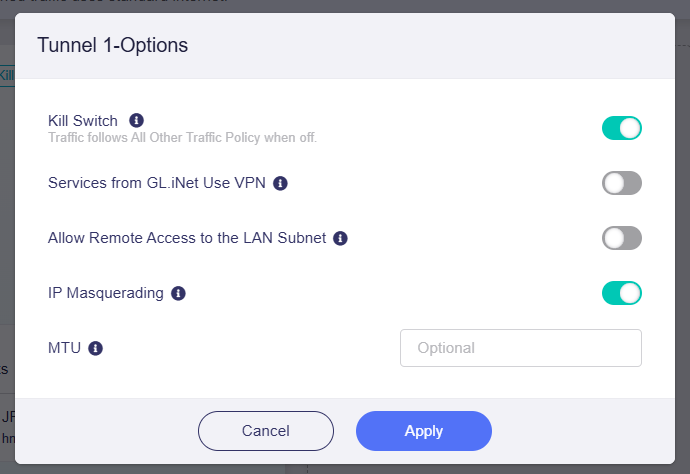

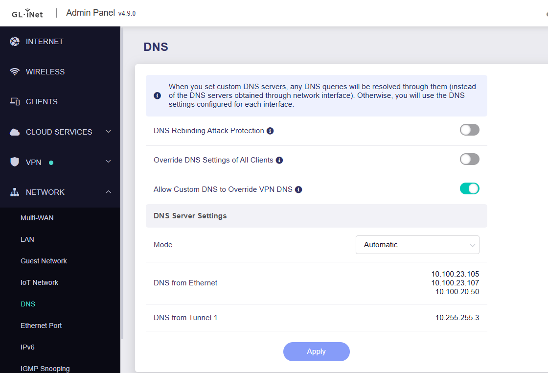

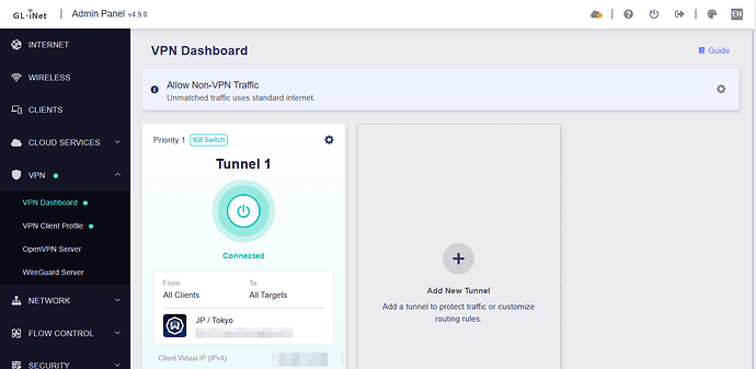

We tested this locally on a Flint 2 running v4.9.0 Release, and everything worked as expected.
VPN configuration:
DNS configuration:
Test results:

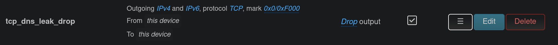

Logging into the Luci interface, and going to Network -> Firewall, the following rule is enabled only when the tunnel is connected:
Disabling it from here while the tunnel is still connected fixes the issue for me - I am wondering if the same rule showed up during your tests. I have not added or modified any of the preset rules.
When running
iptables -L OUTPUT -nvx
From SSH, the related rule shows up with a counter showing how many packets are being dropped. The number goes up directly in accordance with running the dig +tcp command - so it must be capturing it, but I have no idea why it isn't affecting your own setup. I am tempted to try with a factory reset after backing up my config (I've gone through a few firmware upgrades, just official ones). I'll be happy to provide any other information that you think could be useful.
