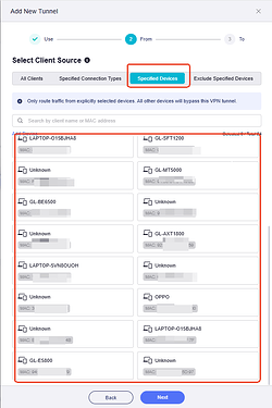

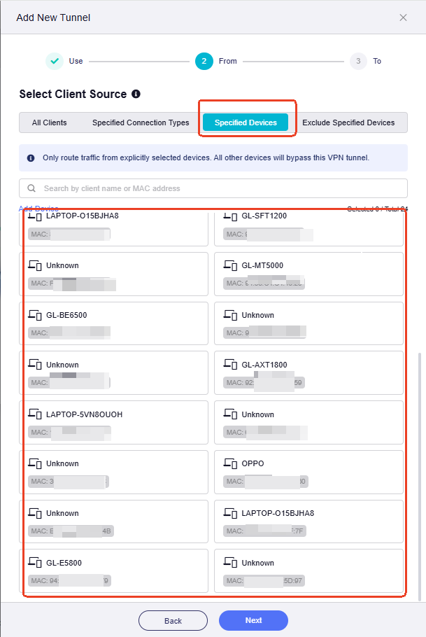

For the additional VPN setup you mentioned, this can be configured through the VPN Dashboard in Policy Mode.
When configuring the second tunnel, select Specified Devices as the client source and choose the specific devices that you want to route through the other WireGuard client.
Devices on the Main Network that are not selected can continue to use the normal WAN connection.
