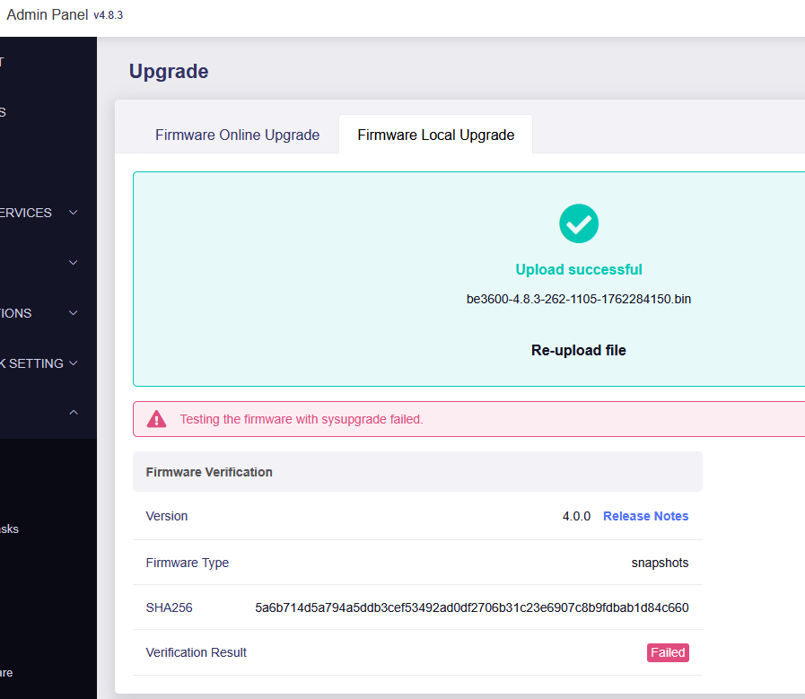

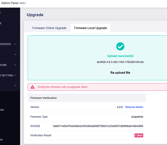

@bruce @alzhao Latest snapshot firmware creates error while upgrading. https://fw.gl-inet.com/firmware/be3600/snapshot/be3600-4.8.3-262-1105-1762284150.bin
I downloaded the file twice. No change.
BE3600?
Flint 3 - BE9300
Wrong firmware selected. This happens because the drop-down menu of the download section changes every day :smiley:
