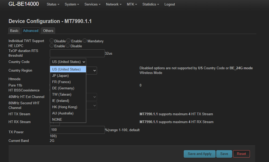

When I went to verify this in Luci using the MTK tools I saw there is no UK country code option and it’s fallen back to the US country code.
Can we please have the UK regulatory values added along with the UK country code?

I think in your case it is probably not visible in the luci app, but by using the iw command I see it is set with your method inside the wireless config.
Can you confirm if the channels are actually valid for GB ?

Thank you for sharing your testing and feedback.
The related country/region options in LuCI are still being adapted and improved, so it will take some more time to complete.
Regarding the Region setting, it is not related to Wi-Fi transmit power and has little practical impact. The available values are CE , FCC , and JAP , and you may select the corresponding region as needed.
Thank you for your understanding and patience.
