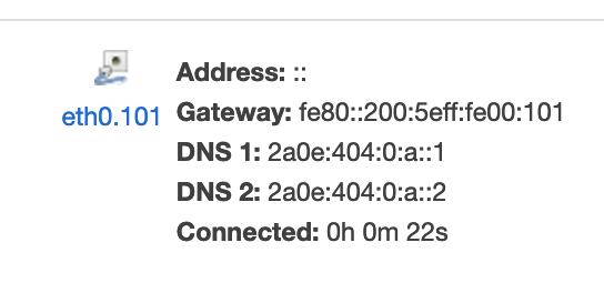

I have this funny behavior with GL-AX1800:
Screenshot 2021-12-14 at 16.36.15
where the DHCPv6 transaction seems to be OK but the interface gets actually no IPv6 Address.
This is the output of ifstatus wan6:
ifstatus wan6
	"up": true,
	"pending": false,
	"available": true,
	"autostart": true,
	"dynamic": false,
	"uptime": 45,
	"l3_device": "eth0.101",
	"proto": "dhcpv6",
	"device": "eth0.101",
	"updated": [
		"routes",
		"prefixes",
		"data"
	"metric": 0,
	"delegation": true,
	"ipv4-address": [
	"ipv6-address": [
	"ipv6-prefix": [
			"address": [COVERED],
			"mask": 48,
			"preferred": 3549,
			"valid": 3549,
			"class": "wan6",
			"assigned": {
				"lan": {
					"mask": 64
				"guest": {
					"mask": 60
	"ipv6-prefix-assignment": [
	"route": [
			"target": "::",
			"mask": 0,
			"nexthop": [COVERED],
			"metric": 512,
			"valid": 1745,
			"source": [COVERED]
	"dns-server": [
		[COVERED],
		[COVERED]
	"dns-search": [
	"inactive": {
		"ipv4-address": [
		"ipv6-address": [
		"route": [
		"dns-server": [
		"dns-search": [
	"data": {
		"passthru": [COVERED]

How to you find the web navigation? Is it good? … thanks for help and support
You wouldn’t notice difference with Sky Wifi Hub in normal use and even in power use with ~600Mbit/s you can stream 4k twice or more without huge problems.
And if the firmware v4 comes out soon things are going to improve for sure. @lizh any roadmap for firmware v4?
Firmware v4 is? QSDK version?
the firmware based on openwrt 21. I red somewhere you guys are working on it.
Sorry but how configure my flint gl-ax1800? arrive today… i already install luci…
@piennepi
I will try to support you:
  1. attach the flint WAN port to the SKY ONT
  2. boot up the flint and initialize it (navigating to 192.168.8.1 should be enough)
  3. ssh your flint from a computer connected to one of the flint LAN ports with something like ssh [email protected]
  4. install the map_4-13 package (pay attention to not install the map-t package) with something like opkg install map (@hansome the package is now online isn’t it?)
  5. amend your /etc/config/network as follows
config interface 'wan'
        option proto 'dhcp'
        option ifname 'eth0.101'
        option ipv6 '1'
        option metric '10'
config interface 'wan6'
        option proto 'dhcpv6'
        option disabled '0'
  1. run the /etc/init.d/network restart command
  2. wait at least 30 minutes SKY needs to understand you are changing router and release a new DHCP lease
That should work.
@piennepi
before…check that you are in map-t 1:1, please refer to https://forum.fibra.click/d/24997-sky-wifi-modem-libero-e-map-t-domande-frequenti-faq to understand what we are talking about
