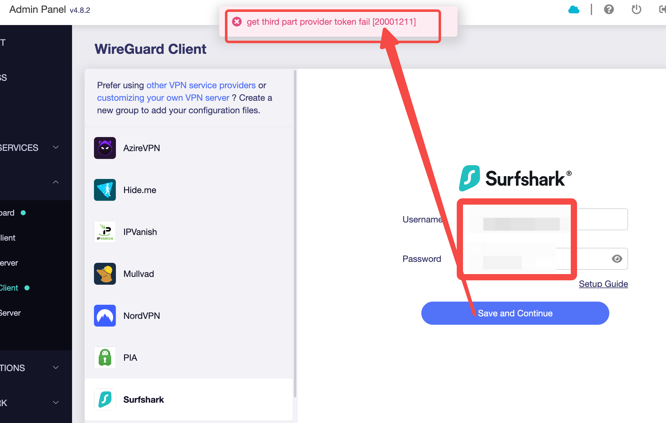

Get third part provider token fail [20001211]
When I try to add Surshark, I always get an error.

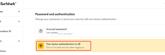

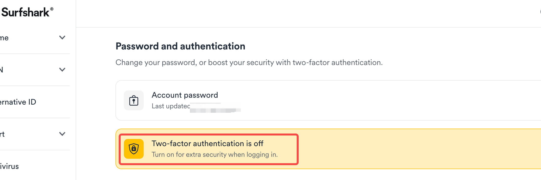

Have you enabled 2FA for Surfshark? If so, please refer to:
I have disabled Surfshark's two-factor authentication, but the error [20001211] still occurs.

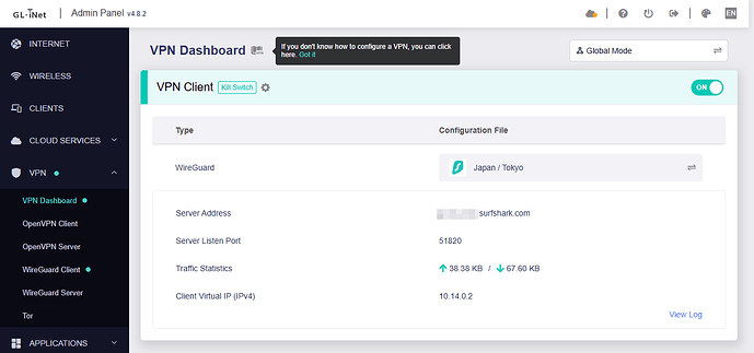

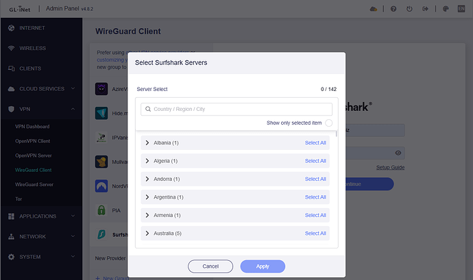

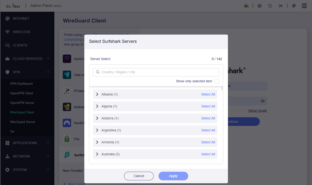

We have tested this locally using ATX1800 v4.8.2 and were unable to reproduce the issue.
Surfshark is able to log in, retrieve VPN node information, and connect successfully on our end.
