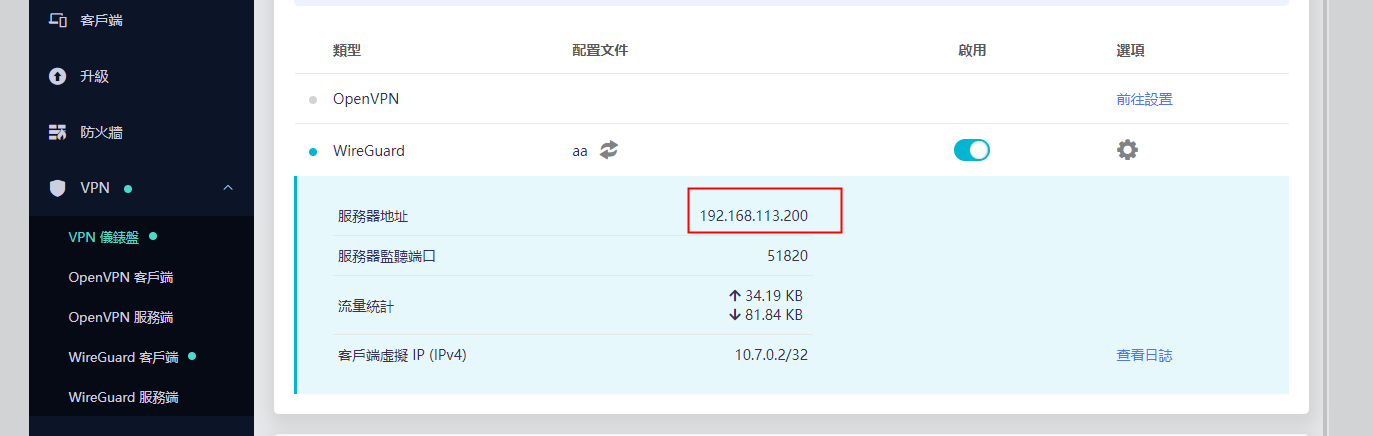

All works as expected and dns can be resolved.
What could be the possible reason?
Dns is rightly displaied. To work dns resolution I have to stop and start vpn policies…After a router restart or if I switch between vpn profiles…
Can you describe in detail? I haven’t reproduced here.
Vpn policies active. Exception (no vpn) for domain list.
Every time I start vpn or I change between vpn profile I have to stop and restart vpn policies to have correct resolution of names.
