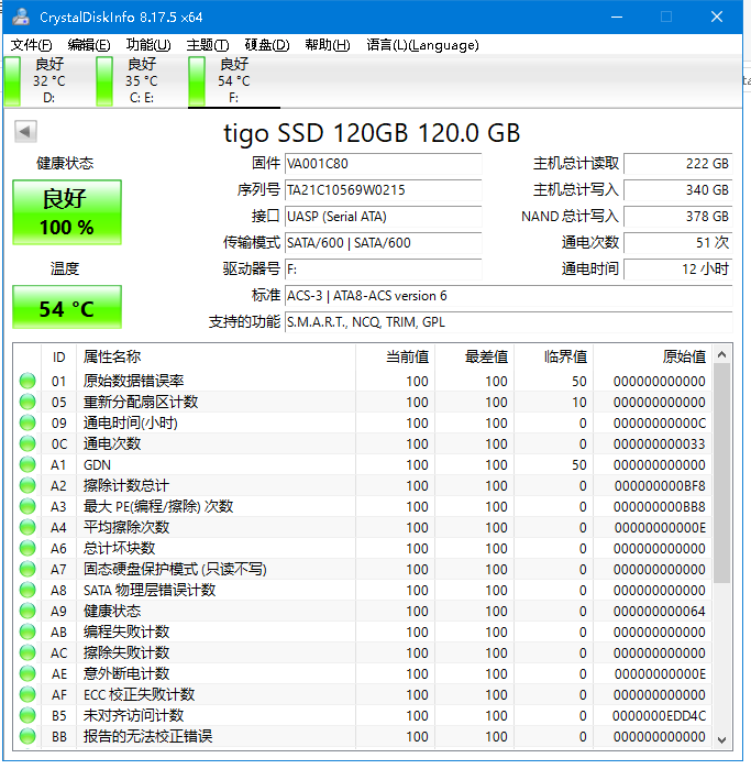

我无法在计算机中获取到SSD的具体型号,只能在硬盘盒表面铭牌上获取
型号是tigo S300 120g

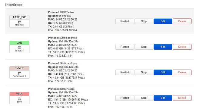

Hello!,

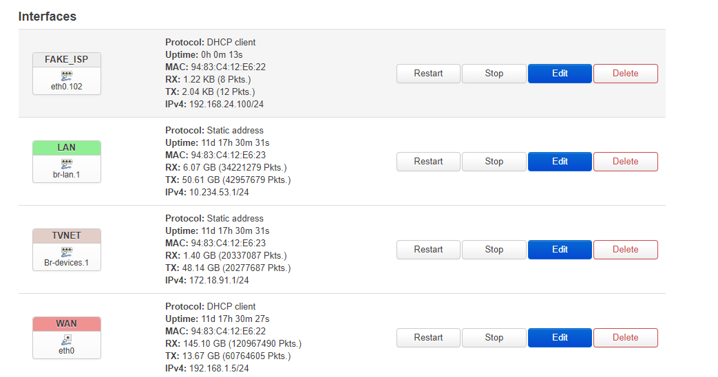

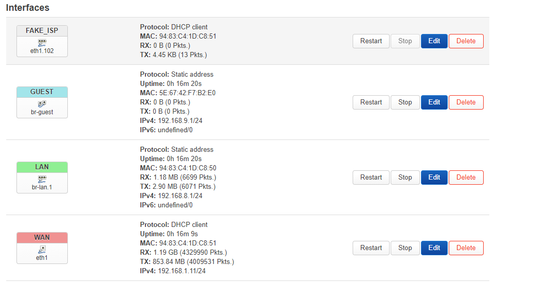

I just tested this again between flint and the A1300 with beta3 it seems it isn’t working.

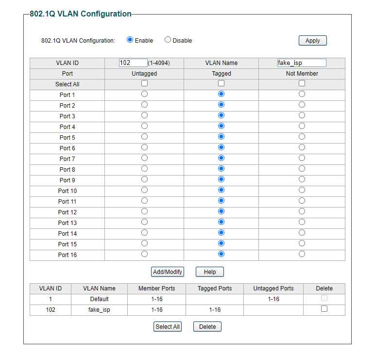

This time I used this in my switch:
on the flint I see with success:
and I tried in the A1300 and I see:
and the bridge configuration on my modem:

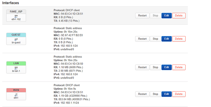

I think the firmware is older for DSA? on my upstream modem with openwrt 22.03 RC6 I don’t see a switch tab anymore but on the firmware for A1300 I do see a switch tab does it mean I have to use the older way?

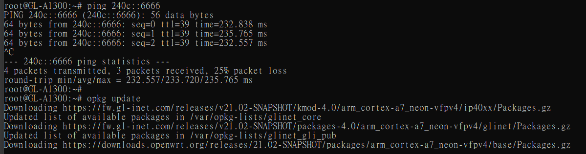

I tried it opkg update okay when ipv6 enabled, accessing internet by modem.
Could you provide more info, like command output and internet access way.
I don’t know if it’s routing issue or what, the GL-iNET repositories are ok but the OpenWRT repositories can’t be reached to any, it get stuck there forever.
Pls use following command, I tried it okay.
uci add network switch_vlan
uci set network.@switch_vlan[1].device='switch0'
uci set network.@switch_vlan[1].vlan='102'
uci set network.@switch_vlan[1].ports='5t 0t'
uci set network.wan.device='eth1.102'
Not sure if ipq40xx support DSA, A1300 need to setup both switch_wlan and eth1.x option.
And I checked GL-AP1300 snapshot firmware(ipq4018+qca8075), it does have switch configuration page.
