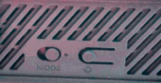

There is a MODE switch on side of the GL-A1300, but no Toggle Button Settings function in Admin Panel.
I am on Firmware 4.0.0 beta2.
