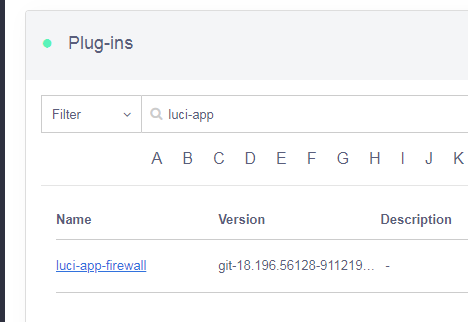

The luci-app-mwan3 package is NOT in the repo. I’ve already checked.
When I check for luci-app the only package that comes up is luci-app-firewall.
If I search for mwan3 only one package comes up.
So, does the repo need updating/fixing? Or is there some other place I can down the package?

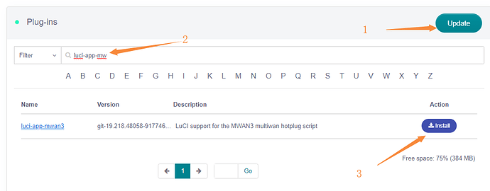

As in my picture, did you click “Update” as the first step?
You just set up repeater in the UI. Save the SSIDs.
The router is doing what you want already.
