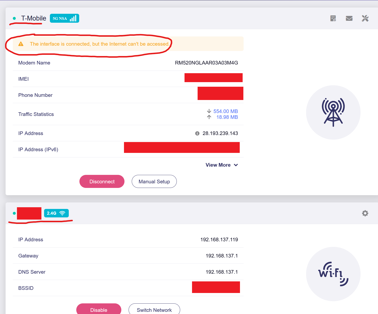

I have a GL-M2 with RM520N-GL connected to the GL-AXT1800 router. After a few hours or days, the router would report error:
The interface is connected, but the Internet can't be accessed.
The internet can be accessed again if the router is rebooted. The USB modem DOES NOT need to be rebooted. This makes me think there is an issue with the router and not the USB modem.

After getting error The interface is connected, but the Internet can't be accessed., I logged in again a few hours later and see the router stuck on:
Connecting…
Some SIM cards have special usage restrictions, for example, the need to use a specific APN. If your SIM card cannot be registered, please check with your network operator to see if your SIM has any special restrictions.
At this point, the AXT1800 needs to be rebooted for internet connection to come back. The GL-M2 DOES NOT need to be rebooted.

@ywp - I just encountered this same issue again where the GL-M2 connection encounters:

The IP address both matches, so your last fix on /lib/functions/modem.sh was able to refresh the IP address.
But this new issue is coming up when I do the following:
  1. Macbook connect to AXT1800 router. Internet works.
  2. Connect to GlobalProtect VPN (work VPN) from Macbook. Internet stop working after connection to work VPN.
  3. GL-M2 connection on AXT1800 router encounters The interface is connected, but the Internet can't be accessed. Internet failovers to Repeater.
@ywp - why does GL-M2 connection break after I connect to work VPN? After failover to repeater, the internet works again and I can connect to work VPN from Macbook on repeater connection. Please check GL cloud (same MAC ID and login password).
