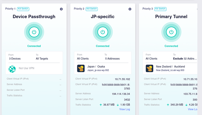

I have upgraded to 4.9.0 firmware, and have a setup that looks like below. Every 10-20 mins or so, I get intermittent periods of 100% packet loss across all devices on my network for up to a second or so (usually less), regardless of which “zone” they’re in, even if they’re in the first bypass all VPNs zone, and have all other stages disabled. This mostly stops happening if I disable all VPN functionality. It does not seem to correlate consistently with anything in the system logs as far as I can tell.
I have tried fully factory resetting the router, as well as reinstalling the firmware, no dice. I also have IPv6 turned on set to native, if that affects anything (I have not tried turning it off, I need it for some stuff in my network)
Manual DNS has been set to Quad9 No Security, but it doesn’t seem to change anything regardless of how I set it.
There’s 3 layers here, nothing is hidden beyond the third one.
This can be seen with a flood ping test, and can also be seen when using Twitch and other sites that use websockets, which lose connection. All DPI features are disabled.
