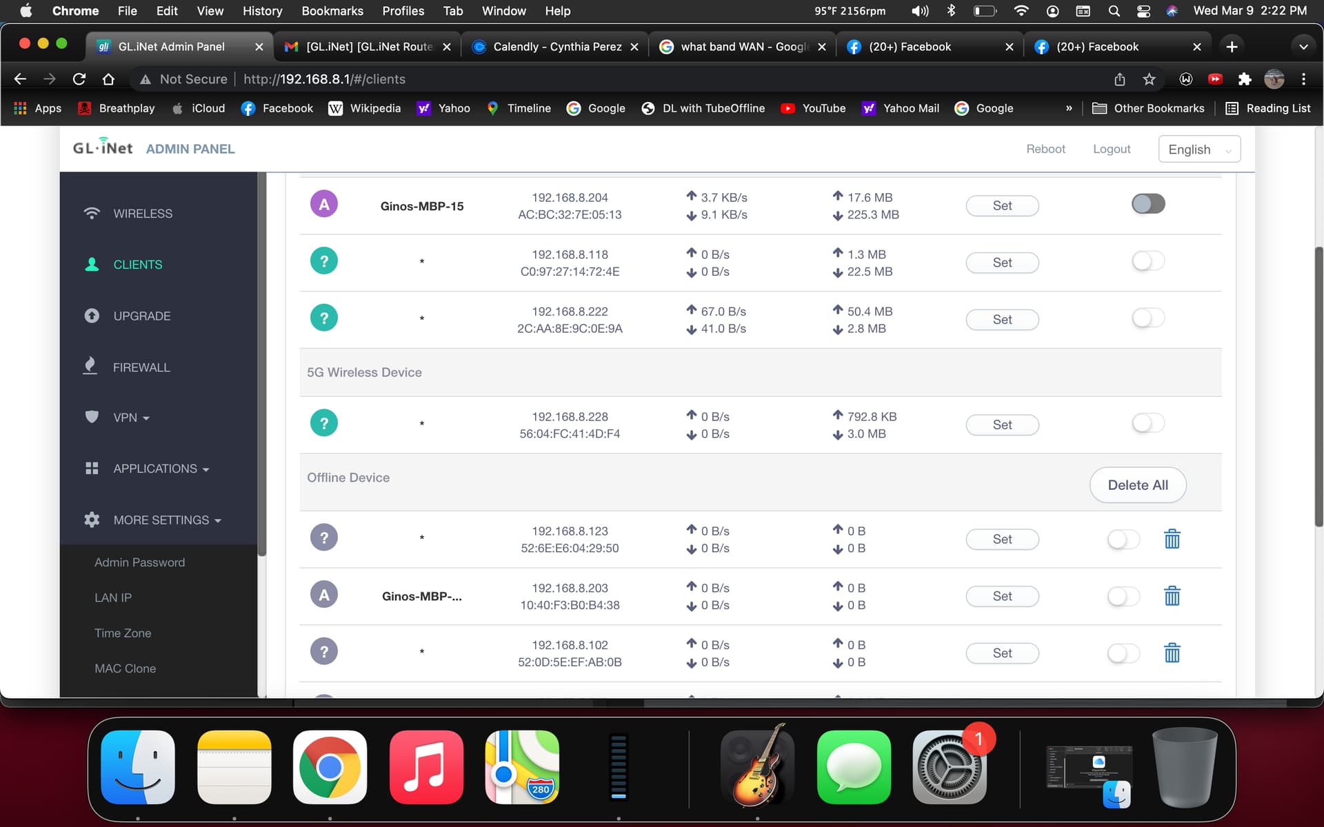

The version is 3.211, and has been for several months. Thanks for bearing with me, i’m learning a lot just based on terms n what not. What gets me is the seemingly complete randomness of bugs without any known changes as a precursor. For example, ive made no changes but for the past 3 days my tv and wyze cameras wont work, the traffic shows numbers but speed is 0 and the devices are offline…what does this mean? In fact all my devices have a speed of 0, despite me writing this email and being online right now.
This router would be so awesome if it werent for all these seemingly random issues with staying connected. Ill include screenshots, not sure if you can see them or what help they are. Again thanks so much, i would be so grateful if we could get this thing to work and at the very least im learning a lot just from having you dumb things down for me. Appreciated.
