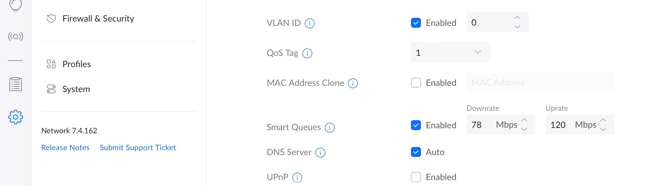

Try connecting the ONT directly to WAN port on the Flint 2 (taking your Sagemcom Fast 5464 out of the connection) and set the VLAN ID: 0, making sure you use DHCP as the connection type.
Edit: I see we can't set the VLAN ID to 0 however try just leaving it blank and see if that works.
Edit 2:
So I managed to set VLAN ID on WAN to .0 via Luci
Go here flint2ip/cgi-bin/luci/admin/network/network
Scroll down and Find WAN, check under the icon what the device name is for WAN, probably eth0, click edit and find the device drop down "eth0" click drop down and go to "custom" type the name of the interface, in this case eth0 followed by the Vlan id name. So for you it will be: eth0.0
Click save and then save / apply.
Let us know how that works.
I'm basing my guide from this post over on the Talktalk forums
Vlan ID is enabled on the Sagefast etc router/s you will need an intervention from TT HQ unless the 3rd party router can be set to Vlan ID 0 zero there is no other way.
If that is the case and setting to zero from within the Luci interface works then maybe the Devs can change the client GUI to accept 0 in the VLAN ID field.
Please try leaving the VLAN id blank in the glinet gui and see if you can connect. If this fails then do the Luci / vlan id zero "0" to confirm if that resolves the connection.
