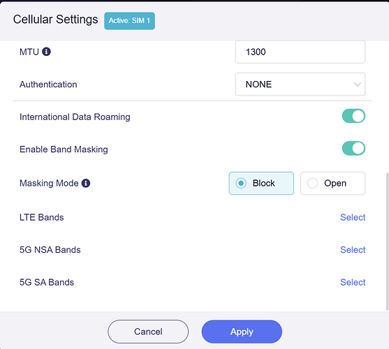

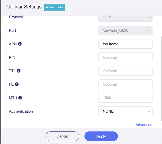

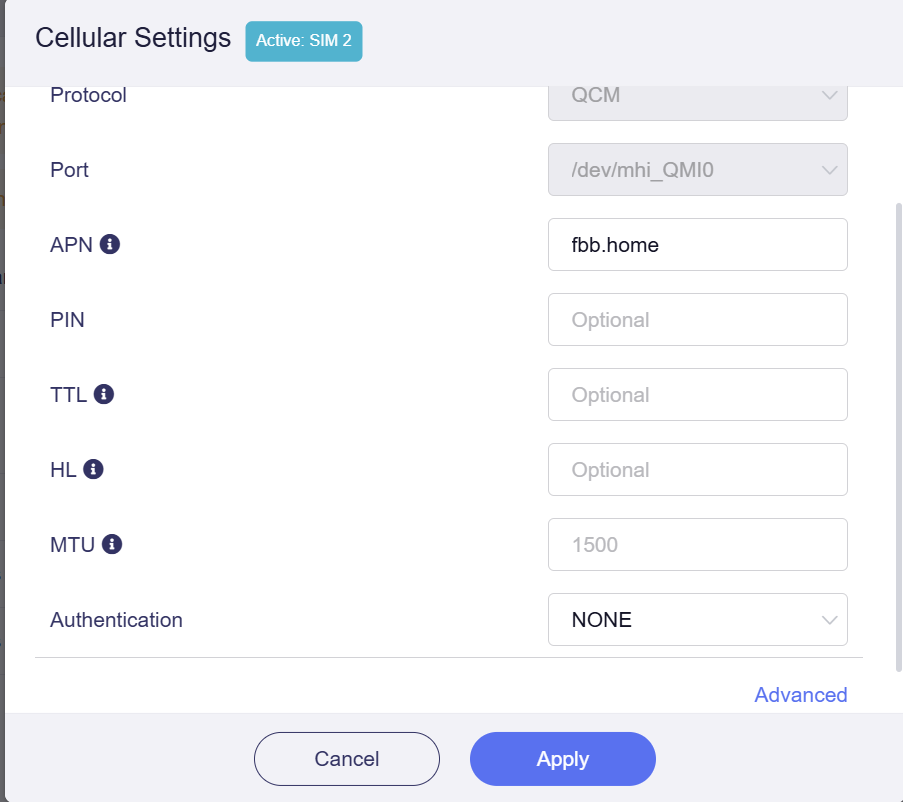

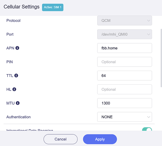

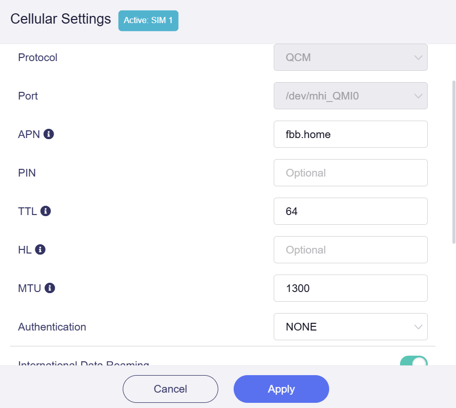

@Cathy: I've attached the files you requested. One system log is with the default APN (fast.t-mobile.com) and another is with the APN manually set to fbb.home. Needless to say, neither works. I've also attached config screenshots of SIM1 and SIM2. On SIM1 I've made some changes based on people's suggestions online. With SIM2 I just have the defaults + the APN change I mentioned above. And again, nothing works.
