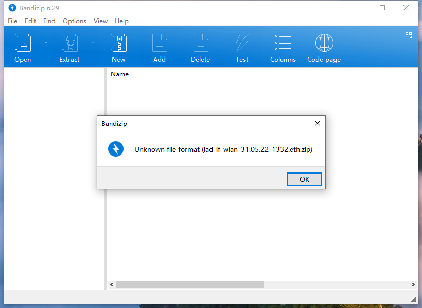

I just renamed the file .zip, because I know I was allowed to upload it. It is a plain pcap dump.
I can’t open the zip file from you.
Need to change to .pcap
The forum don’t like the file extensions .eth (original created) or .pcap. So I’tried .zip and it worked. I wasn’t interested in zipping 190kb for real. My fault to be such lazy.
