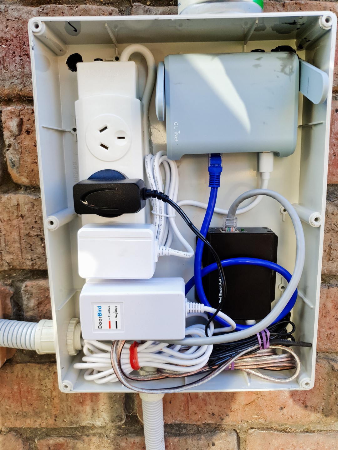

My use case was to install a Beryl router in an outdoor enclosure functioning as a wifi bridge to provide ethernet connectivity to a Doorbird intercom.
After downgrade of FW to 3.203 the solution works fine until there is a power outage. When power is restored, the Intercom does not receive a DHCP lease.
According to Doorbird, the intercom will re-try for a DHCP lease every 2-3 minutes for 15 minutes but it is not happening.
The fix is to wait until Beryl is booted and then power cycle the Doorbird.
If I have a laptop plugged into Beryl and simulate the same power outage, the laptop receives a lease without issue.
Is there a way to pull DHCP traffic logs from the Beryl while in repeater mode?

Can you confirm that the router is in Extender network mode via Admin Panel → MORE SETTINGS → Network Mode? If it is, then try unplugging and plugging in the Ethernet cables to get IP addresses from your main router.
Extender network mode uses Layer 3 relayd routing, which DHCP broadcast does not work that well for.

That is exactly how I have setup Beryl by changing network mode to extend.
There is no physical connection between Fritz and Beryl, just wifi.
I am wanting Beryl to extend my LAN over Wifi such that my intercom can get an IP lease from the Fritz 7490.
It works fine until power is cut as the intercom boots before Beryl and is unable to obtain lease and for some reason future DHCP requests fail.

Did you try unplugging and plugging in the Ethernet cables to get IP addresses from your main router?
Due to Layer 3 relayd routing, I avoid Extender network mode. Unfortunately, OpenWRT does not seem to have a “Client” mode that are in other routers, which should work for your use case. I use one of these other routers for an inkjet printer.
Hi wcs2228, yes that fixes the issue.
The problem I have is that all equipment is in a weatherproof enclosure which is painful to access
The blue cable goes to a PoE injector which then feeds the Intercom.
ok, so for this particular use case, Beryl may not be the best optioin.
Any small OpenWRT client mode routers you can recommend that would fit my enclosure?
Can you set a Static IP address on the Doorbird Intercom (same IP address as it would get via DHCP)? If so, that would be easiest to do without buying and wiring new equipment.
