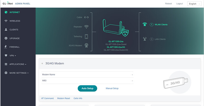

I connect the phone and it said connection established but I saw that in the admin panel is requesting the 3g modem information. I need to do another adjustment in order to make easy tether work?
I finally got it to work, it works great!!! Now I just don’t understand why in the dashboard is not detecting it as Tethering it just appears 3G 4G modem like if I was going to connect thru that, but I’m already with internet connection, is there a way to make it recognize it as Tethering in the dashboard?

Still in the Admin Panel I don’t see like is receiving connection from any source instead is requesting to connect to 3g or 4g modem, but i do have internet access at full speed. Surprisingly amazing, way way way better than expected.
If there is any work around to make it detect that is getting internet from a source that way the LED will stay solid white instead of blinking Blue.
As the UI is not compatible to work with easytethering, so it does not show the correct info.

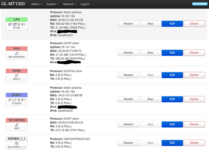

Once you log in to Luci go to Network and select Interfaces, that will send you this first screenshot.
I notice that you can select either WAN or Tethering or probably create a new Interface, once decided which one click on edit and go to the second screenshot below to se next step.

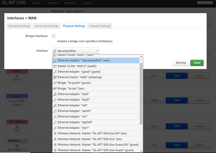

Once on Edit go to Physical Settings Tab, open the Interface select menu and select the adapter marked on the screenshot ( Ethernet Adapter: “tap-easytether” (wan)), then click save, go to the next screenshot below.

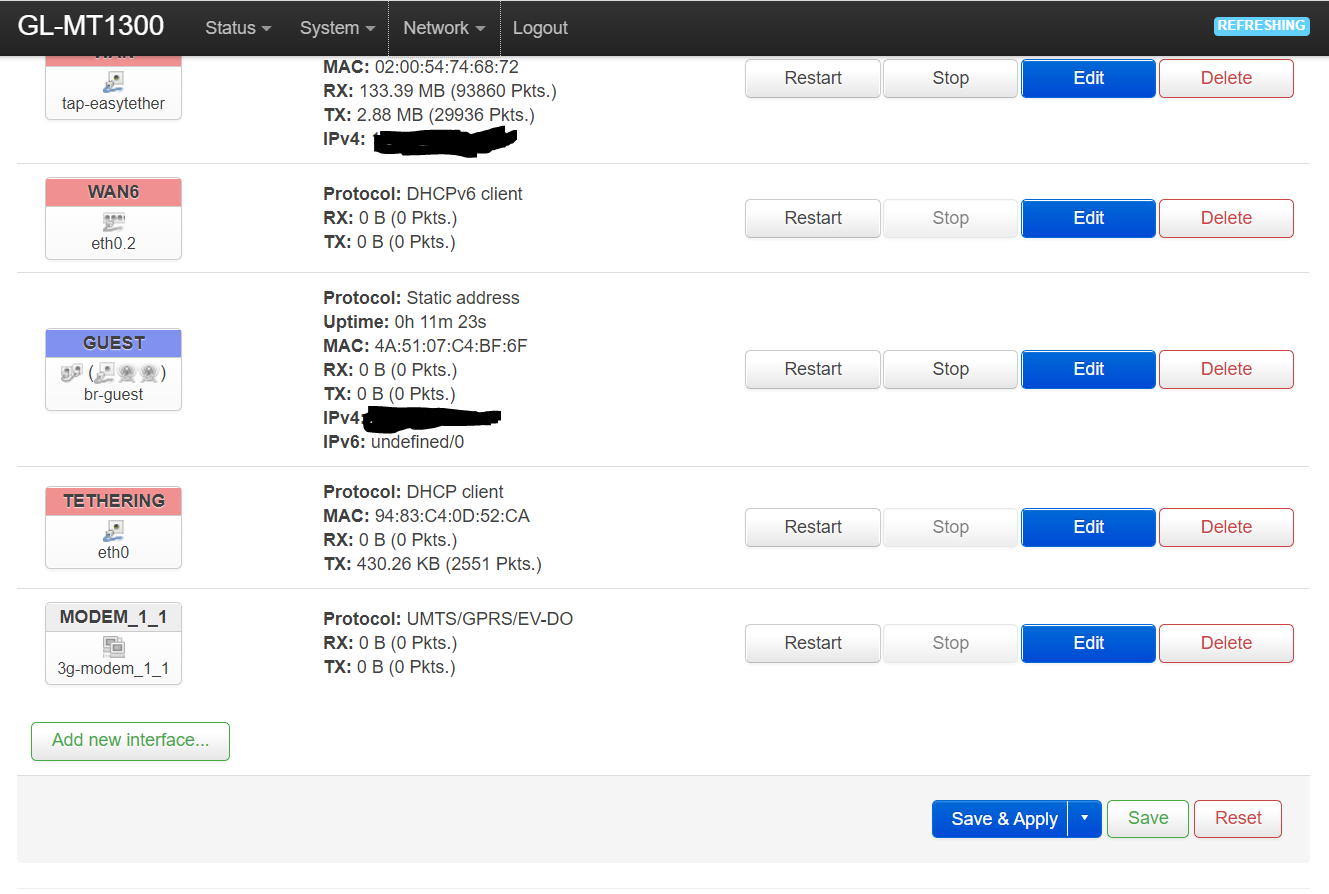

Now click Save & Apply, the router will reboot and you should have now internet connection with no issues at all, just don’t touch your phone leave it there connected. the GL-MT1300 (Beryl) wifi signal is surprisingly big enough to cover a full home. This device so far works amazing.
