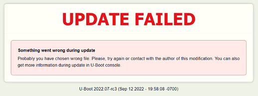

I then tried to recover it using the UBoot. It starts all well, I can access the firmware update page (192.168.1.1), upload the file (router’s led are blinking during the upload), the process goes to 100% and all seems to be fine.
But as soon as I press ‘update firmware’ the following error message appears:
Something went wrong during update
Probably you have chosen wrong file. Please, try again or contact with the author of this modification. You can also get more information during update in U-Boot console.
I tried almost all firmware files that are available (GL.iNet download center) - from earliest to latest, but the error is always the same!

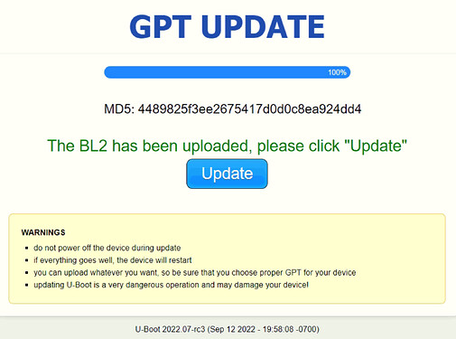

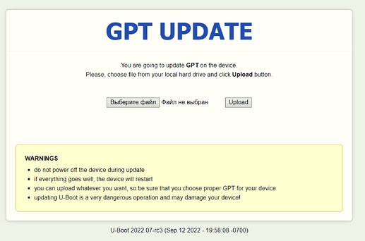

I attempted to perform the GPT update, but it was unsuccessful. I put the Brume2 into UBoot mode and managed to accessed the GPT update page at:
http://192.168.1.1/gpt.html.
Upload the file:
Everything seemed fine until I pressed ‘Update,’ but immediately after, the following error appeared, same as the firmware update error via UBoot.
