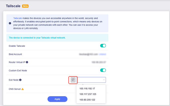

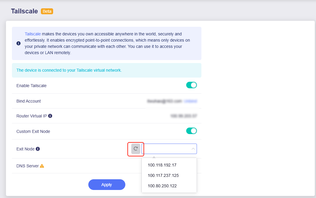

I have the exit node enabled in Tailscale however there is not options for me in my GL INET admin panel under exit nodes when I check it off theres is no IP address Why?
Please first click the refresh button
