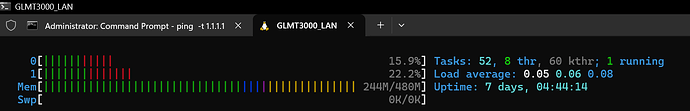

i did some more testing, paying attention to the cpu and memory usages.
from htop, each second the cpu usage changes but not more approx. 20%
i am correct, that my issue is not related to cpu usage or lack of memory?
if correct, then what is causing my issue?
