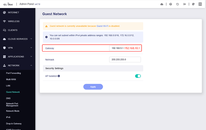

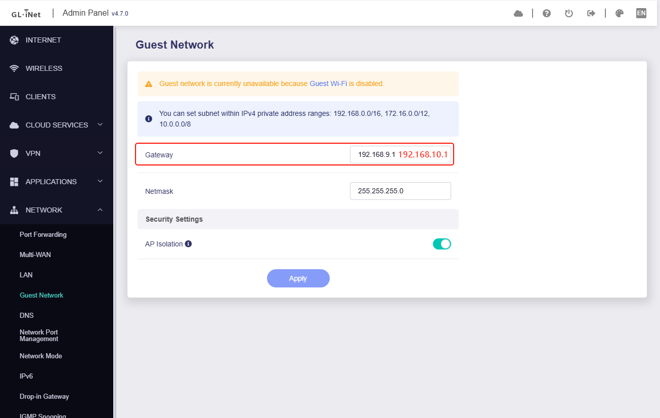

Change the Gateway of Guest Network to 192.168.10.1
Thank you. I found out yesterday. I just changed the 4G router's default 192.168.8/255 to 192.168.9/255. I didn't remember that the guest network was also on 192.168.9.1. My solution was to move the 4G router's default network but yours is fine too.
