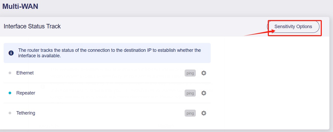

When the ISP's cable fails, it takes a certain amount of time to detect, and only after the failure is confirmed will the WAN network source be switched.

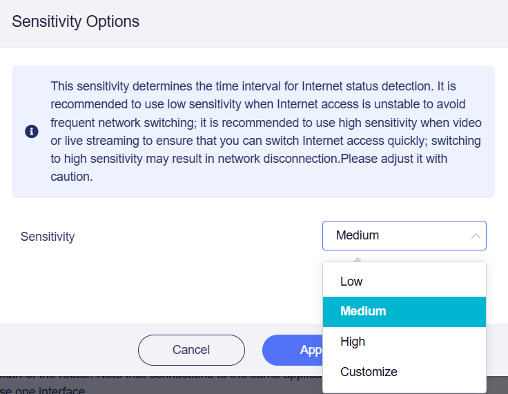

You can try to set the sensitivity to reduce the detection time.
The weird thing is, I lose any connection as soon as I plug the ISP's cable.
I tried Low and High (Medium being the default) but to no avail. No failover to the 4G router's connection :frowning:

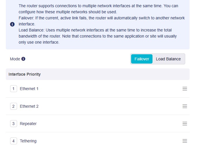

Have you moved the priority of the connection to suit your setup? Towards the bottom of the multi-wan settings page you can move them up or down based on desired behavior
Here is my current setup
My desired behavior is Ethernet 1 (the currently failing ISP is plugged in here) has priority over Ethernet 2 (where the 4G router is connected) but only if Ethernet 1 is live. The problem is, the failover didn't work as expected: there is no Internet through Ethernet 1 and yet the router didn't get it from Ethernet 2.
If I unplug the ISP cable from Ethernet 1, I have a working connection from Ethernet 2 :sweat_smile:

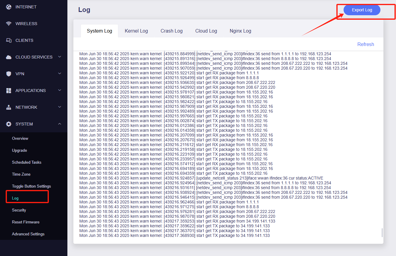

We hope you can try to reproduce the problem again after the router is started and export the log to us.
Hi there,
The txt log file you sent is incomplete and does not contain much information.
It is recommended that you use SSH to execute the following command to increase the log level, then reproduce the failover problem again, and then export the entire log file package.
echo 3 > /proc/gl-kmwan/debug
Please export the log here, do not just copy a section.
