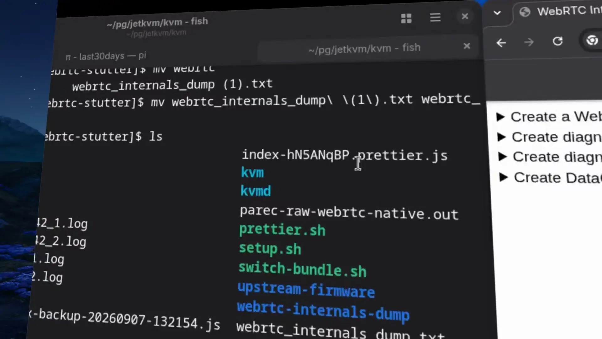

Here is a screen recording showing the screen judder issue. The framerate drops to less than 1 frame per second.
GLKVM-stutter_trimmed

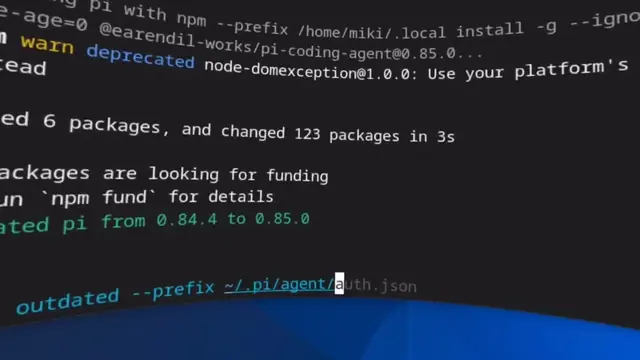

We have a working fix for the video judders / freezes in WebRTC(Native) mode as well, more information to come soon.
With our patch: no more video stutters, even during many hours of use, see screen recording:
GLKVM-no-stutter
