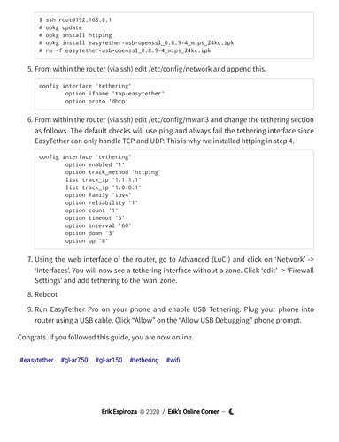

You would be better off getting the GL-MT1300, & install EasyTetherPro on your S7. Your gonna have to install the driver on the router, then follow the installation instructions. Once I did this it works like a charm every time.
These instructions also work on the GL-750S Router, which is better then the GL-750. Once you follow these instructions, you’ll be able to tether from your S7 without a problem without running down you data. If you hook your S7 up directly to the router without using EasyTether you will run down your data
It took me some time to figure out exactly how to do the command prompts properly, but in the end it worked perfectly. It’s flawless.
When you got to youtube, no one really has a clear straight foward video of how to do this, but believe me, it does work. You’ll get 2.4 GHz & 5 GHz at the same time, you’ll also be able to plug it directly into the ethernet plug running off of the 4G network from your cell phone, with no major data loss.

I tried this but is not working for me I have a Oneplus 6. also tried in Mango about a year ago and no luck
Did you enable developer options & turn on USB debugging
Make sure the wifi if turned off on the phone before you hit enable.
Yes Developer options enabled and usb debugging on and wifi off and no go for me.
