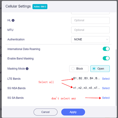

Can you follow the operation on the picture and then test it? Maybe your sim card doesn’t support the 5G SA band

Maybe you could try this, too?

i did it and try it, after an hour is downgroaded to 3G

i will give a it a try, yes i can do it via vi or nano, just modify the line and i will see if it drops or not.
i did this (Except the 5G SA Band, i kept it open, doesn’t matter i try to hold 4g and not 5g ) and it holds 4g now for more then 2 days whit the latest firmware 4.0408release3
so the masking mode (open) seems to work!
