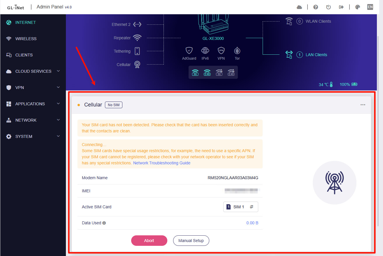

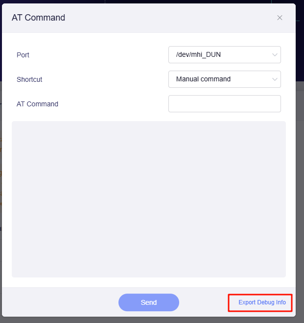

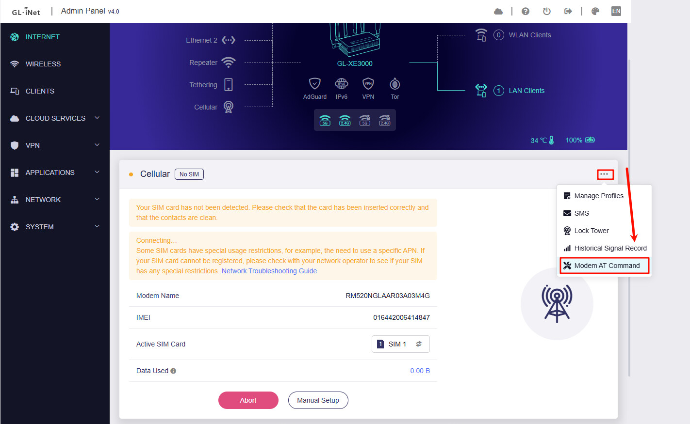

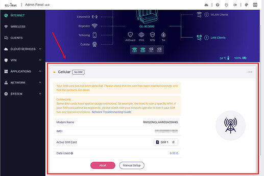

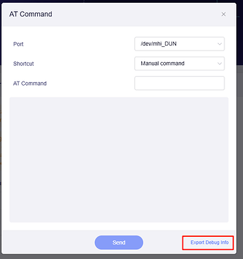

After the issue occurs, please:
  1. Share a screenshot of the Cellular status with us;
  2. Export the Cellular logs;
  3. Export the device logs;
  4. PM these logs with us.
  5. Try running the following AT commands to see if they resolve the issue:
AT+CFUN=0
# Wait 10 seconds
AT+CFUN=1

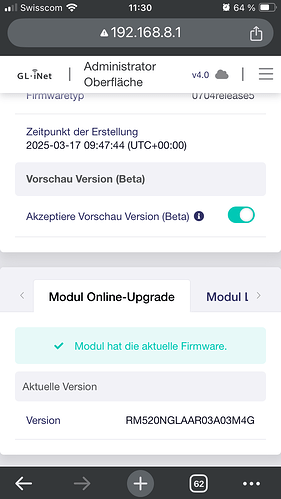

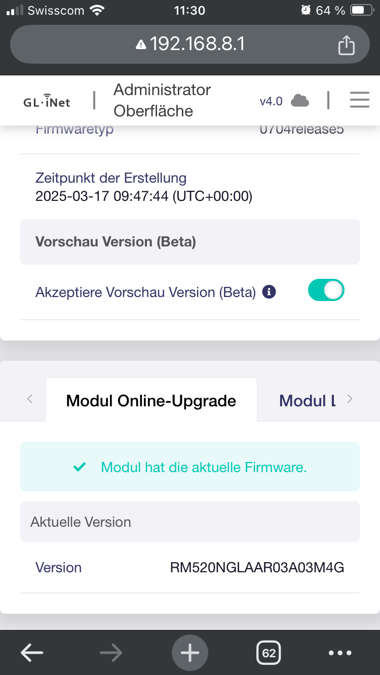

I will also try to update the firmware for the router and the modem.
The system however tells me that I am already using the most recent firmwares.

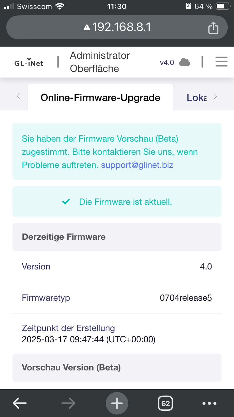

In regards of updating, it seems I am on the actual status. Except for beta versions.
Which updates (to which versions) do you recommend?

Please try upgrading the device firmware to beta 4.8.2.
It can be download here: GL.iNet download center
Regarding the cellular module firmware, please try
