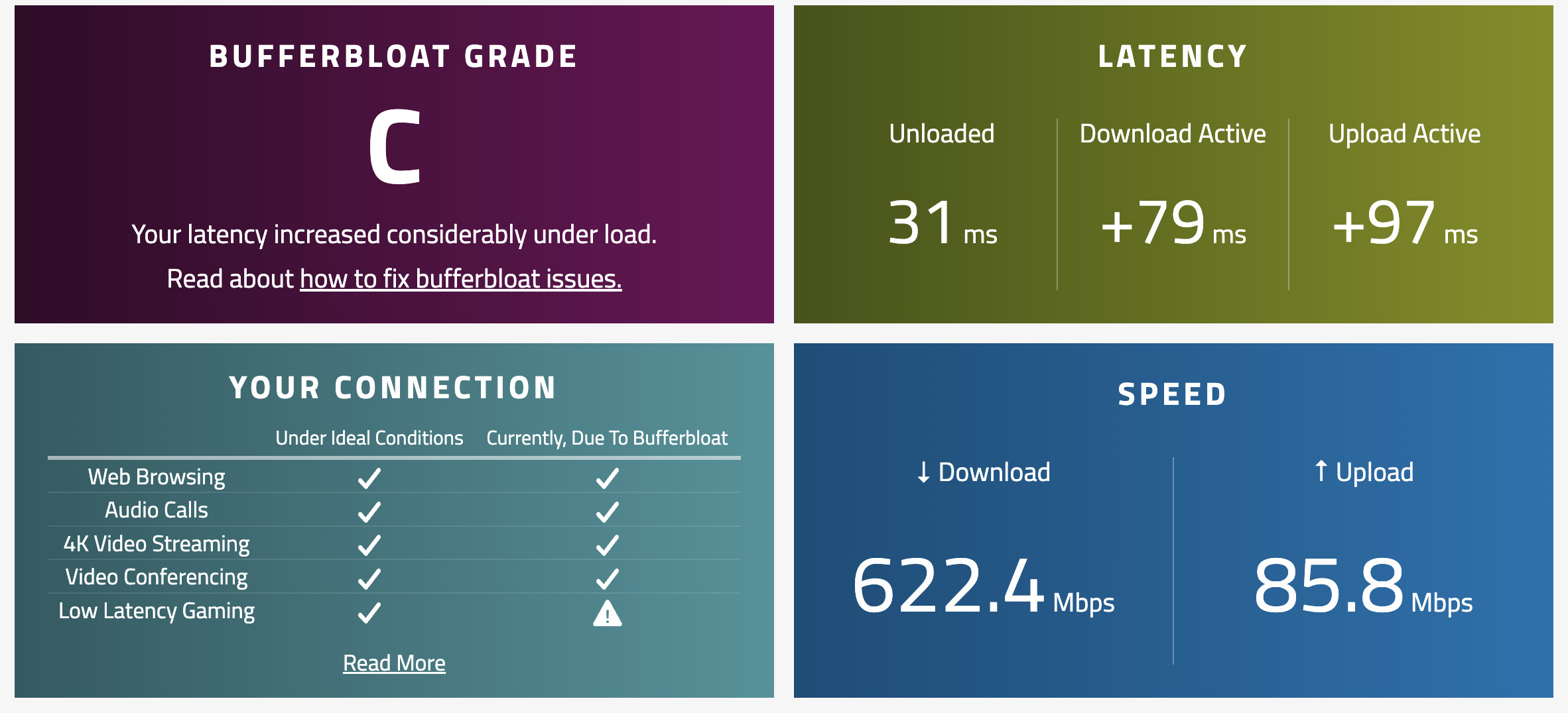

LAN over [GL-X3000] connection:
Please what could be the bottleneck? Where should I look? Can I read the temperature and fan RPM somewhere?
In general I feel very good about the router, great specs, software seems robust, just a new product with some things to patch. Unfortunately for me not usable with conferencing right now. (Zoom debugging runs flawless, it's very strange).

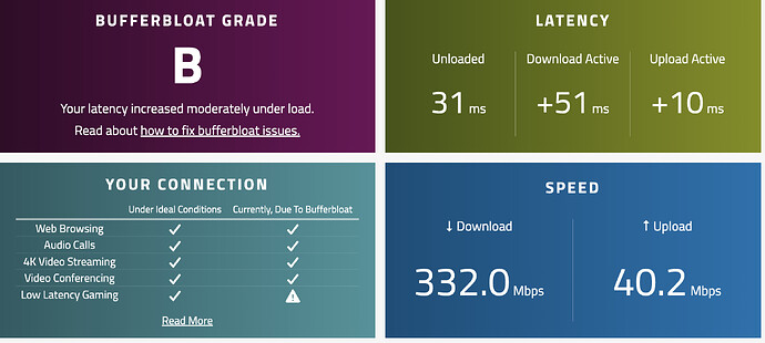

What is realistic for 5G SA? My unloaded ping isn't great, but I managed to stay under the limits when under load. I’ve also seen an A+ grade once, but that was with a higher unloaded ping I guess, but not even similar to yours in the screenshot.
at me, if SQM disabled
if SQM enabled (tutorial), I have restricted the speed, as of DL 450000 kbps and UL 45000 kbps
