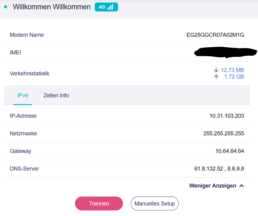

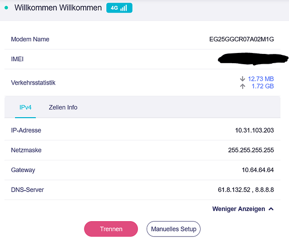

I’m operating several GL-X300B Rounters with built-in cellular modems. In general the routers fit perfect in my solution and they do exactly what they should and the connection seems to be very stable. At some spots a power drop occurs and after the router is back, the modem does not reconnect. When I pass by the location, I can see that the router is up and running and the HTML interface tells me that the cellular connection is fine, but in fact it’s not. If I perform a reboot via the admin interface it seems not to work. If I do a hard reset on the modem via menu, everything is fine again.

This is how I found the router:
Firmware Version:
