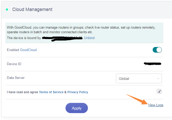

I would like to know about this service:
  1. How the router communicate to the goodcloud server?
  2. What encryption method is used?
  3. Which information is shared?
  4. Can we have access to the code of the software or script?
  5. Is it possible from the server side, I mean, for the Gl-inet staff to access all my router configuration?
I’m concerned about the security of this service.
Thanks
  1. via mqtt protocol
  2. AES
  3. Only basic setting
  4. No, what do you want to do?
  5. It can’t so far. But we are planing to add remote tty, which allow you ssh to the router, so you can control it fully.
What’s your usage scenario?
Thanks for the reply.
Can you be more specific on question 3?
And for question 4 I’m concerned that someone else could access my configuration in the router and that’s why I would like to see the code.
Now your router’s setting is not stored on the cloud. The cloud only know it is online/offline and your IP etc.
All the info you can access from the browser is get from the router realtime. We also removed all admin password, wifi password in all of the data from the router’s API.
@alzhao, to use goodcloud.xyz to monitor many router is good. Having the IP address and the status (Online or Offline) is good. But I would be very worried if I can control my router right from goodcloud.xyz. It only means that people just need to break into my account in goodcloud.xyz to take control of all the routers. It is good if the router Only supply the basic info to goodcloud.xyz. There should not be critical info like login password be sent from router to the goodcloud.xyz. That is probably why our friend here is asking for the code to assure himself.
You are right @Sunny. I checked and the application /usr/bin/gl_mqtt_cli calls the application in /www/api to get the information. We know that a mqtt server has control over a client, and if the server is able to send a restart command, can change a SSID, can change the transmit power, can block stations, we know it can do all it wants, as send a copy command to get more information that the one showed in the control page of Goodcloud. Is for this reason that we should have access to the code, to be sure that the staff in Goodcloud is not getting more information that the one showed in the page, and to be sure that the communications are secure and that there is nothing that could be done without our permission.
I’m only testing goodcloud on my home network with a few GL.iNet routers attached and it is quite handy. I would feel more confident if there was something like a 2 Factor Authentication (say Google Authenticator) layer on top purely from an access to Goodcloud point of view, especially if I had heaps more devices or in a more commercial environment. Just my 2c worth :grinning:
I checked /www/src/store/api.js and I found this, and it’s possible to take full control over the router from the server.

Data security and Privacy are our first priority concern.
Now, only the functions on the Goodcloud UI is implemented, which means other APIs are not callable now. But of course those APIs can be implemented after further development.
Password, including Admin password and WiFi password is not sending to the cloud, or send via cloud. We just removed them from the APIs in the router.
You also have the log in the router to see which API is called.

I know what is your concern!
You can just turn off Cloud in your router’s UI and then no day is send to the cloud at all.
I have told you what data is transferred and that is what it is. Nothing hiding! The router even keeps the logs there and every api call is recorded. I have stated in one above post of that will be enhanced so you can choose to wait until these features are available to use the cloud.
Anyway, do no need to use the cloud at all if you do not need to. You can even flash firmware from openwrt directly and problem solved.

gl-mqtt, you can remove it.
