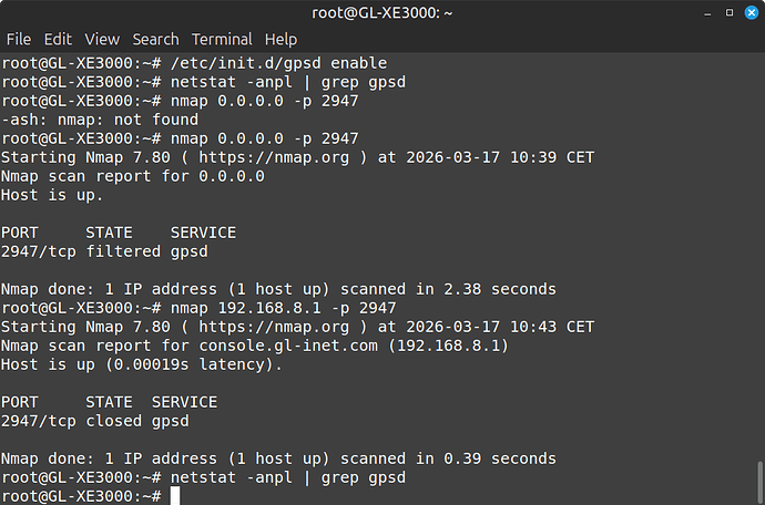

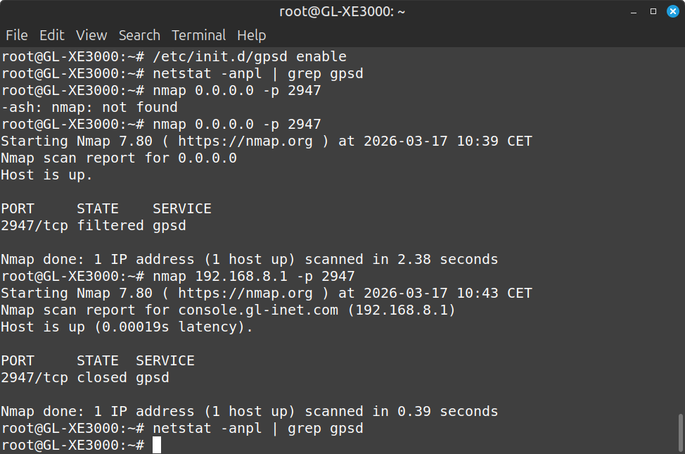

Still no netstat.
Then i installed nmap to see what you have without tailscale, just local.
0.0.0.0 state is not open but filtered, 192.168.8.1 is closed
