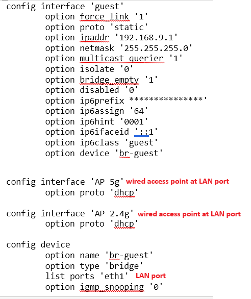

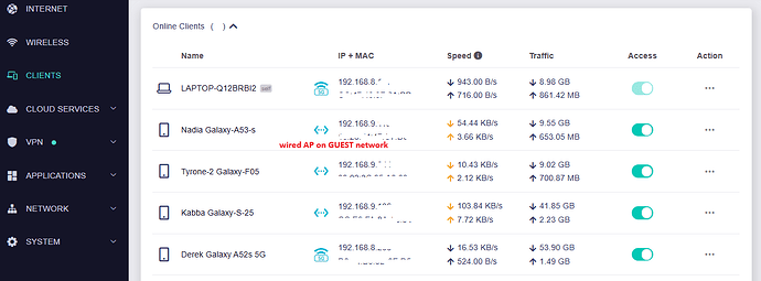

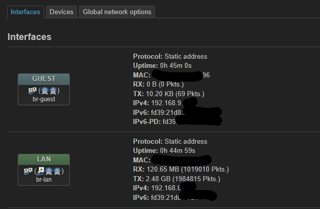

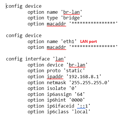

I am pleased to report that after perusing a few posts I have successfully achieved my goal.
I used WINSCP to edit NETWORKS in etc/config.
I have attached here 2 images of sections edited in NETWORKS file and 1 image of the web interface.
