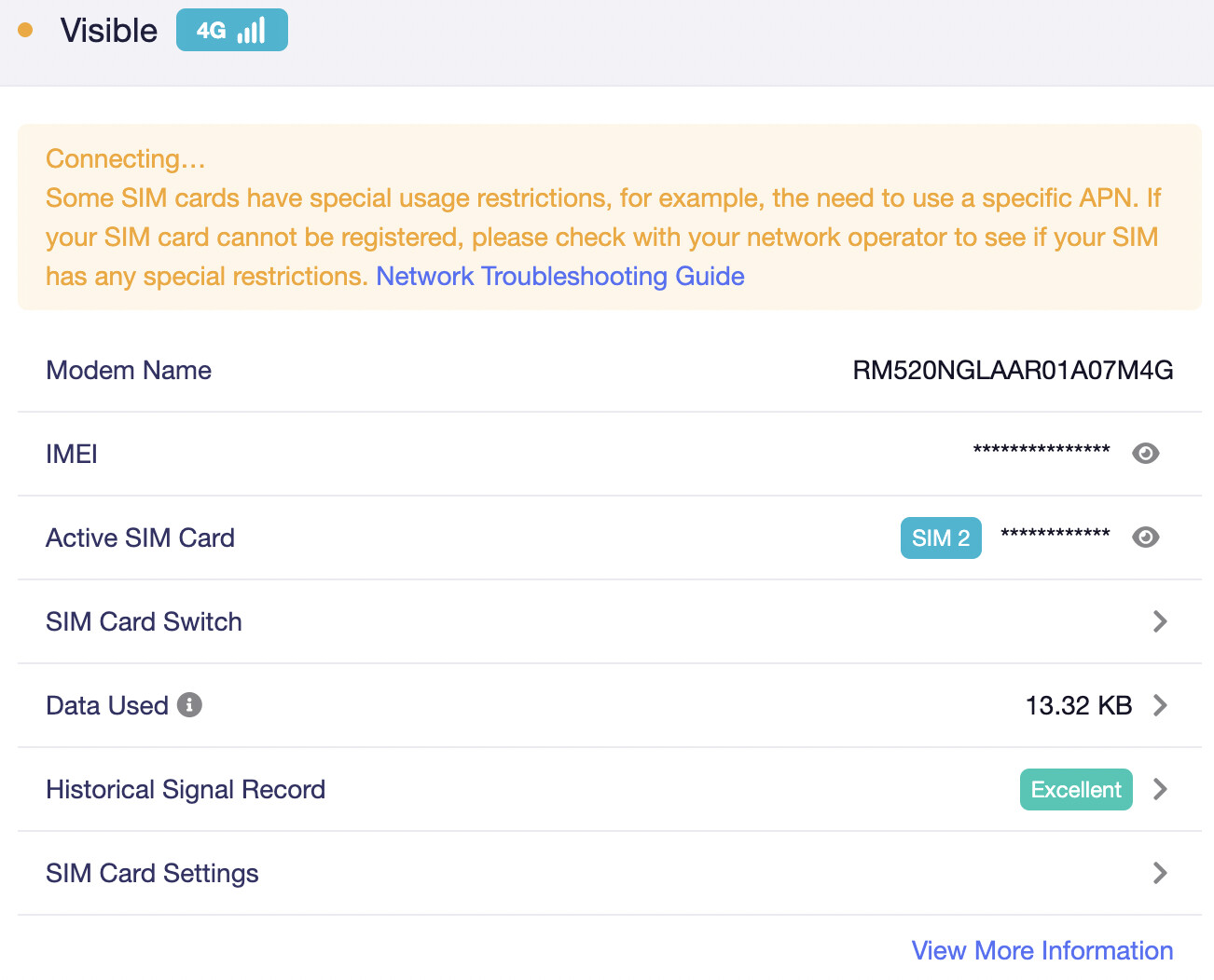

Visible had been working for me in my GL-X3000 for over 2 years. It has now stopped working. I believe the upgrade to v4.8.3 dated 2025-11-13 is the culprit, but I’m not sure. Also, bizarrely, when installing this firmware it claims to be the “v4.0 0803release”, which I believe was a firmware release from 2023. So that’s weird. But the SHA256 matches up with what is published on the GL.Inet Firmware Download Center.
GL-X3000 connects fine to the cell network, but will not connect to data.
No matter how many times I “Abort” and “Connect”, it will never connect to data.
If I remove the SIM and put in the Pixel phone whose IMEI I cloned to the GL-X3000, it works just fine: I connect to Visible and have data. If I remove it from the Pixel phone and put it back in the GL-X3000, it still does not work.
I believe the v4.8.3 firmware upgrade may have also upgraded the modem firmware, but I am not certain. The current modem firmware version on my GL-X3000 (via AT+QGMR) is RM520NGLAAR01A07M4G_01.201.01.201

Thanks @fratermus , I guess that’s both good news and bad news for me. I really have no idea how to debug this. I’d really like to gain access to the modem logs so that I can actually see what the modem is trying to do and where it is failing. I was advised by gl.inet support to update the modem firmware, which I did, to version 01.202.01.202 which I downloaded from gl.inet, but it made no difference.
