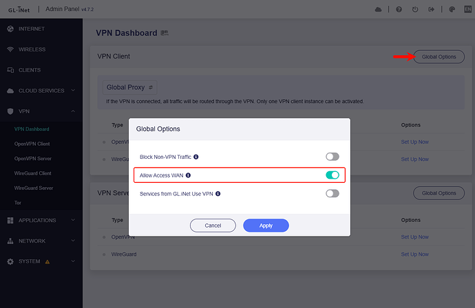

From your description, when Opal is in AP mode, I assume that devices which on the WAN "10.32.10.0/24" subnet should be available to access.
When Opal is in Router mode and the VPN Client disabled, can the WAN subnet "10.32.10.0/24" be accessed?
If the VPN Client is enabled, the WAN subnet "10.32.10.0/24" cannot be accessed, please enable option "Allow Access WAN"
