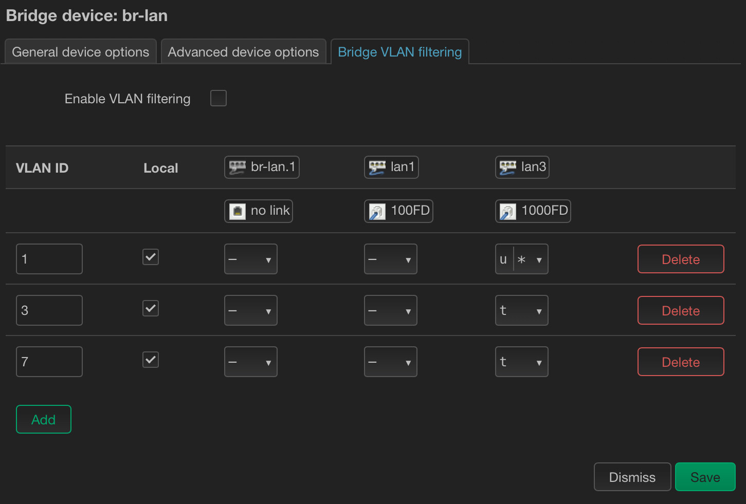

However, if you do need to extend the networks to an external VLAN capable device like a managed mini-switch, then here’s an old post where I included some screenshots of how I extended VLANs out to my managed VLAN capable mini-switches.

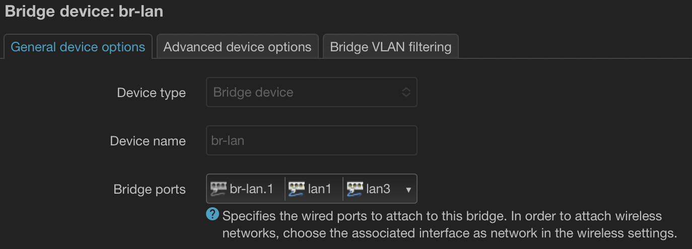

Uncheck the LANx interfaces on the 'br-lan' bridge interface in the bridge ports drop-down that you want to connect to each ethernet connected hub. This will remove the LANx port(s) from the primary LAN network.
Example: Uncheck LAN3 for internet allowed network and LAN4 for as needed internet network.

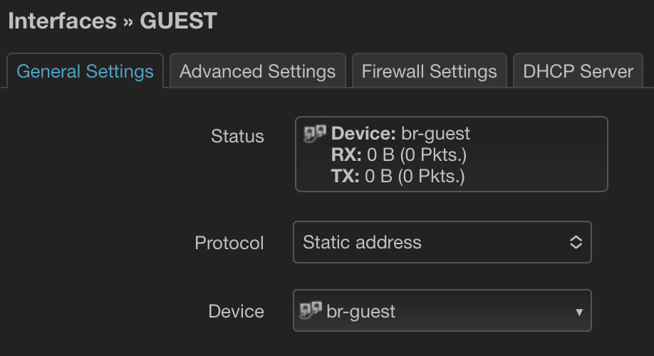

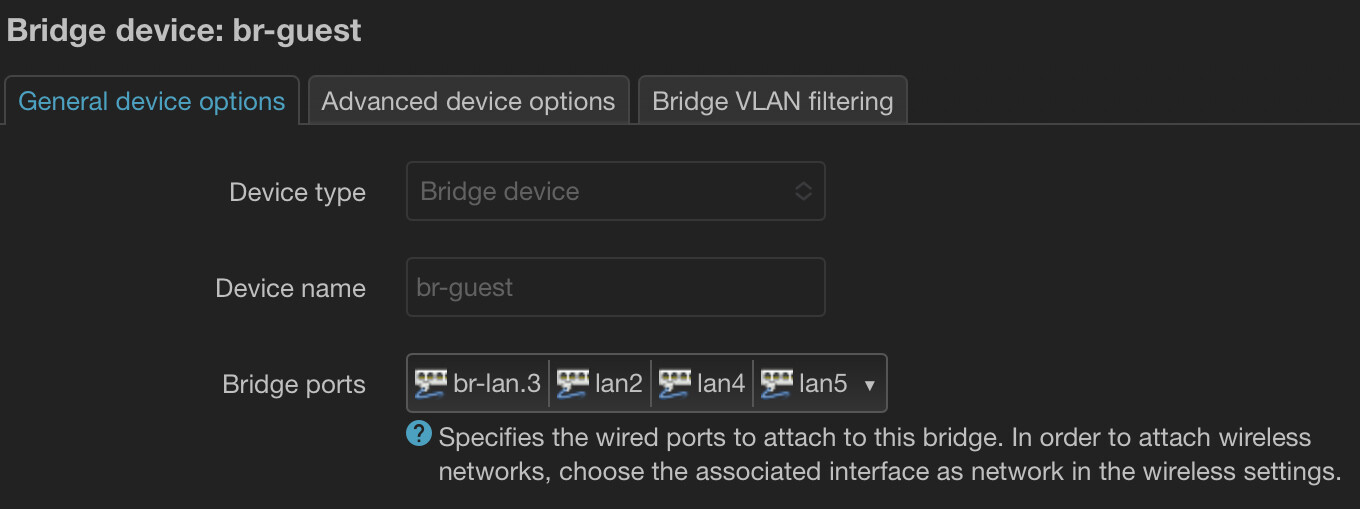

Here you go:
