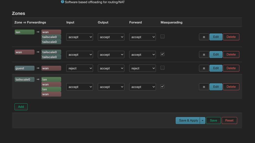

May I know why there are two tailscale0 zones here?
Please try to upgrade to the latest firmware without keep settings, such as v4.8.3:
Please reconfigure tailscale in the GL GUI, and approve the LAN and WAN subnets in Tailscale. No need to go into Luci to configure the firewall, the firewall rules of tailscale zone are accurate and available by default.

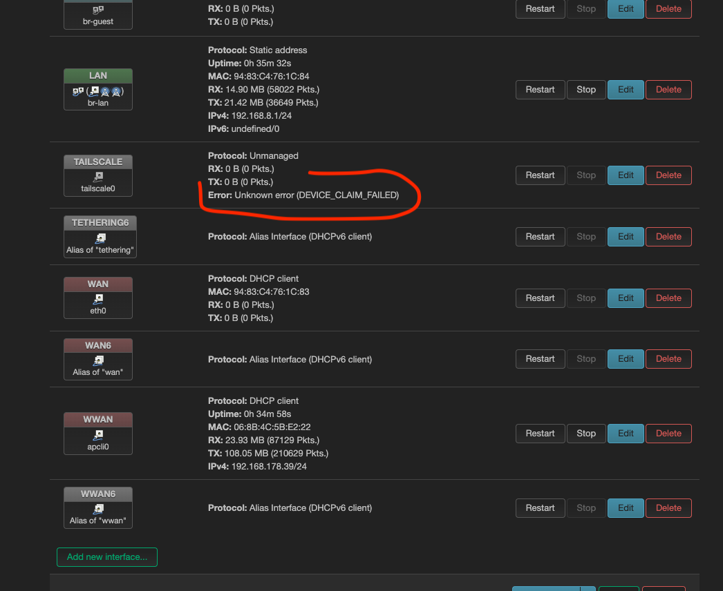

On a separate topic - I went ahead and followed this wiki guide, set up a new interface, added the forwarding rules and now Tailscase connection becomes unstable. Also, when I go in the interface overview, the “tailscale” interface I set up, restarts every 2-3 seconds. Interestingly enough, the connection is very laggy, but I do manage to open a page or two.
Just as an FYI, the only reason I am installing Tailscale is to have my home network as the exit node. I do not need access to any of my lan devices
Edit: The only time I am able to make it work is when I set up the tailscale interface as in the wiki guide. The problem is the connection is not stable and I see frequent Error: Unknown error (DEVICE_CLAIM_FAILED) error messages.
And it looks like when the interface goes down, the tailscale connection in the gui resets (goes from green to yellow and reconnects), which kind of defeats the whole purpose.

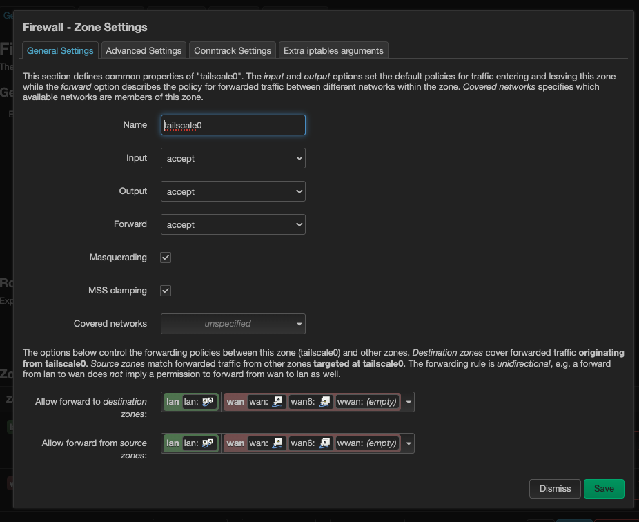

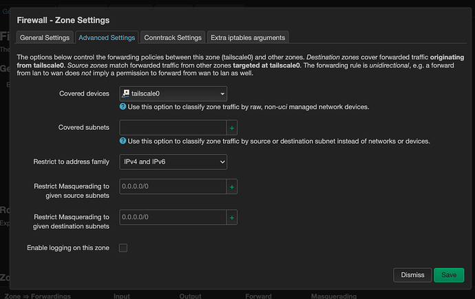

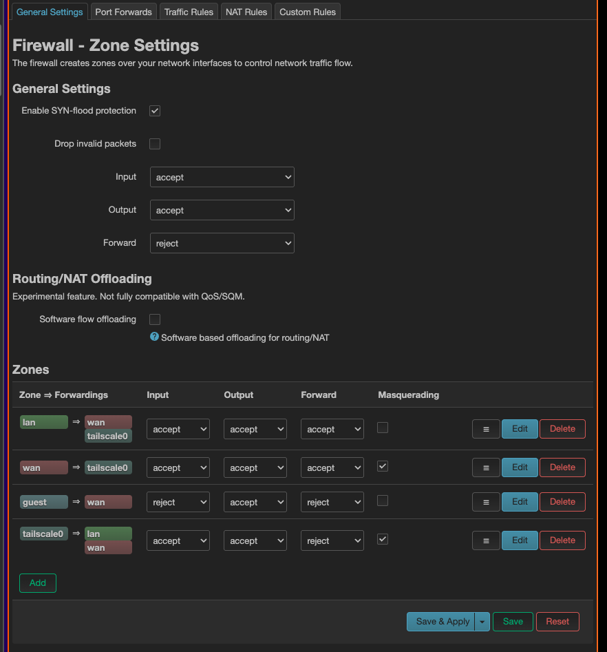

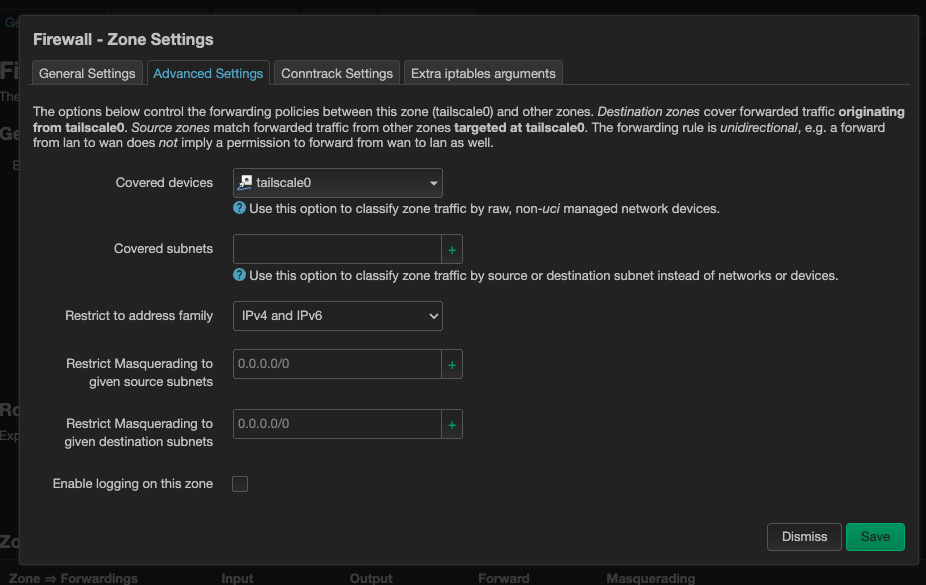

Either way, I have resolved the issue and here are the firewall settings that work for me.
Important: I did not add a new tailscale interface as that one was causing problems, however I do have tailscale in the covered networks
