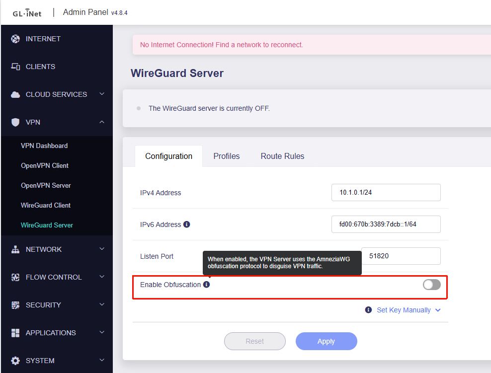

If you are referring to the WireGuard VPN server functionality, you need to manually enable the “Obfuscation” option to provide Amnezia WG support.
ok, I am on the latest snapshot for my beryl ax, slate 7 and flint 2 and don’t see that obfuscation switch under Wireguard server.
The snapshot version should not yet fully support Amnezia WG.
At the moment, only specific beta firmware versions are available:
  • For Beryl AX, please use v4.8.2 beta
  • For Flint 2, please use v4.8.99 beta
  • For Slate 7, there is currently no version that supports it yet
