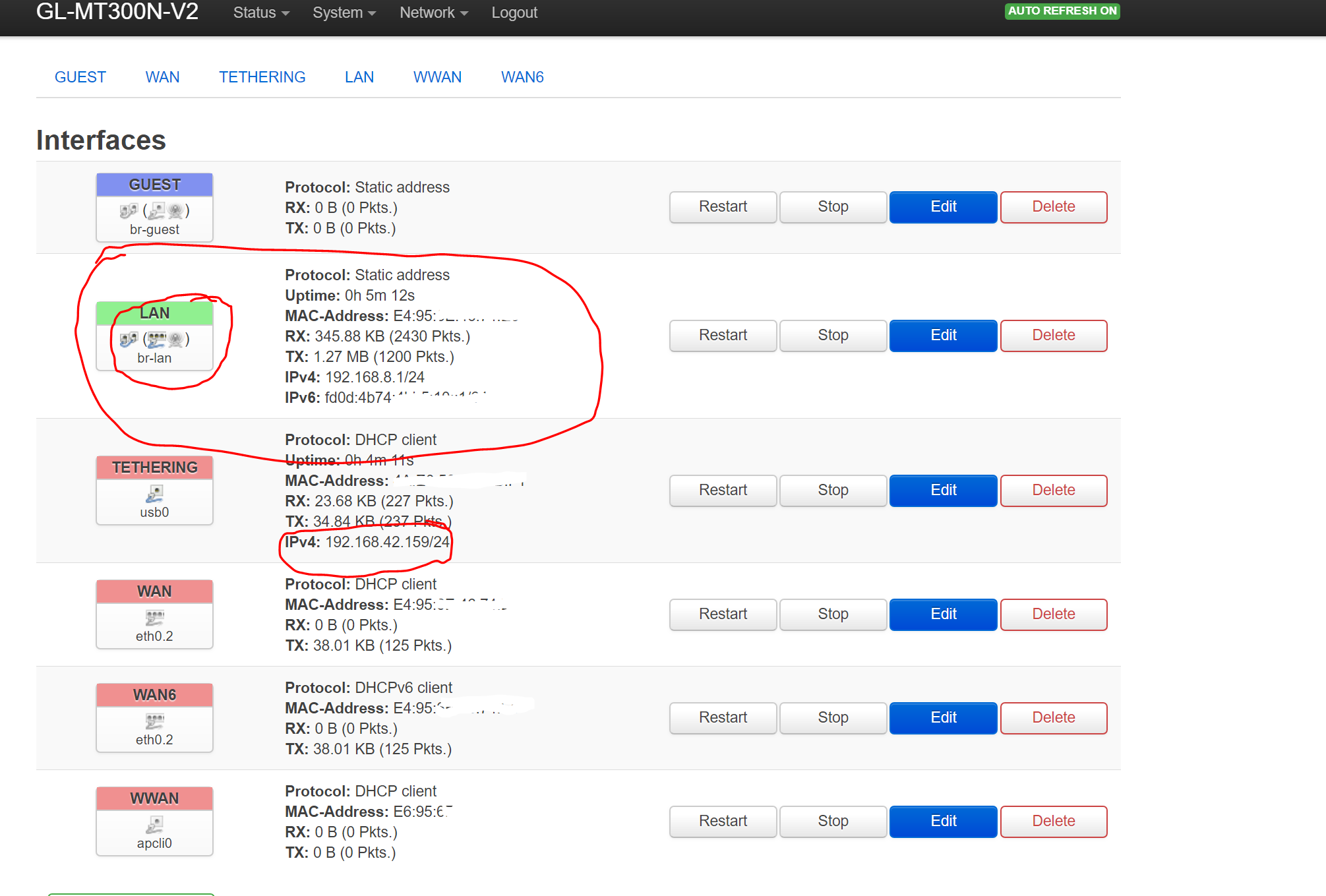

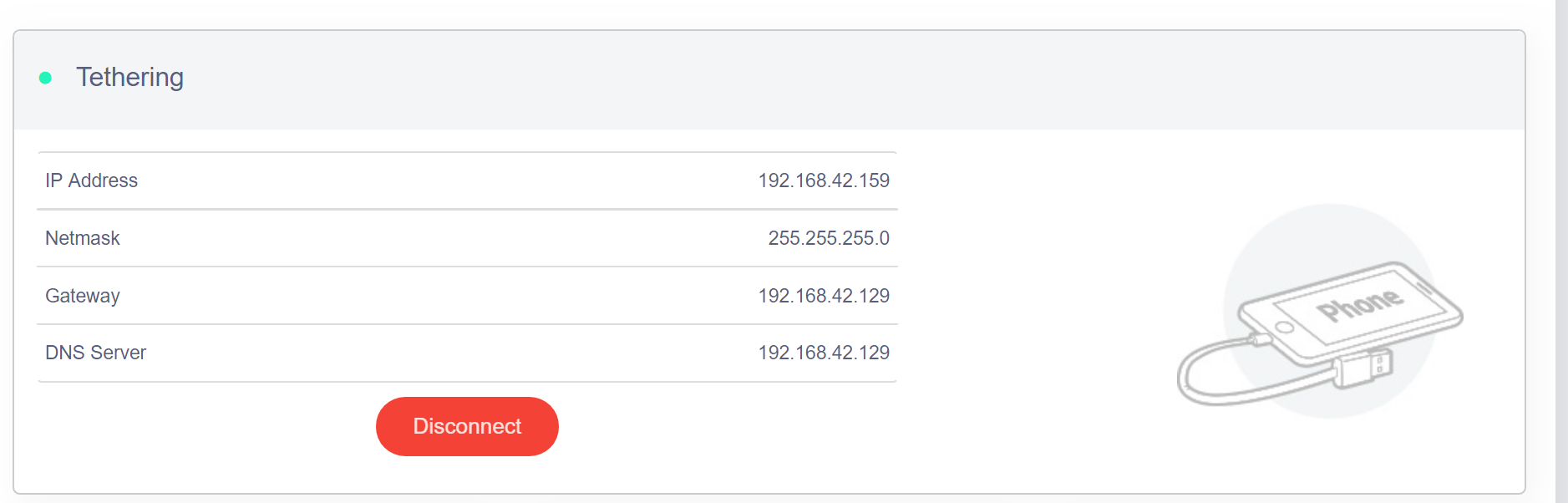

Don’t have a MiFi with me at the moment but here’s a few screens that show what my Mango looks like if I USB tether my phone . I basically just plug in my phone, set to USB tethering, it shows up on the main GL.iNet interface and I click connect.
My Mango is subnet 192.168.8.X, you can see here that the tethered connection is showing the 192.168.42.x subnet from my mobile DHCP.
Here’s the LUCI interface screen (Network->Interfaces). You can see the bridge LAN/Wifi on 192.168.8.x and also the tethering on 192.168.42.x

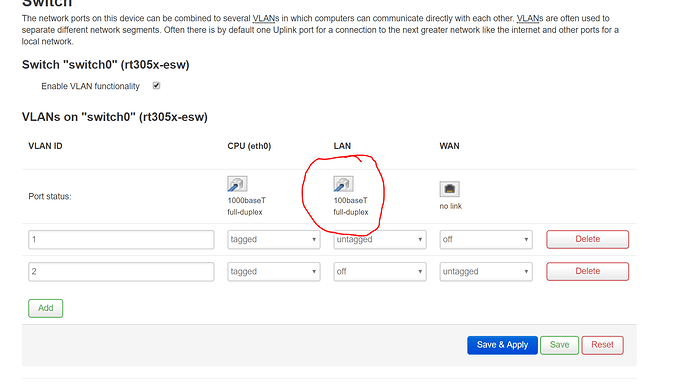

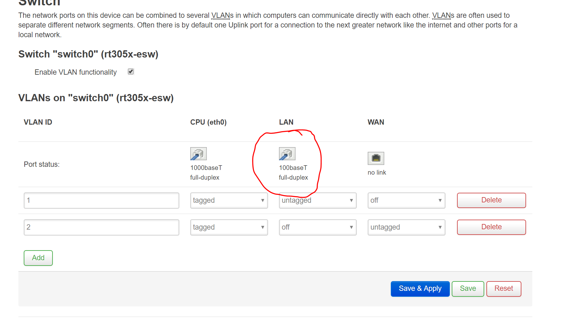

With LAN cable plugged in I can see an active link and have internetz. (Network-> Switch)
Do your interfaces look similar? :slight_smile:

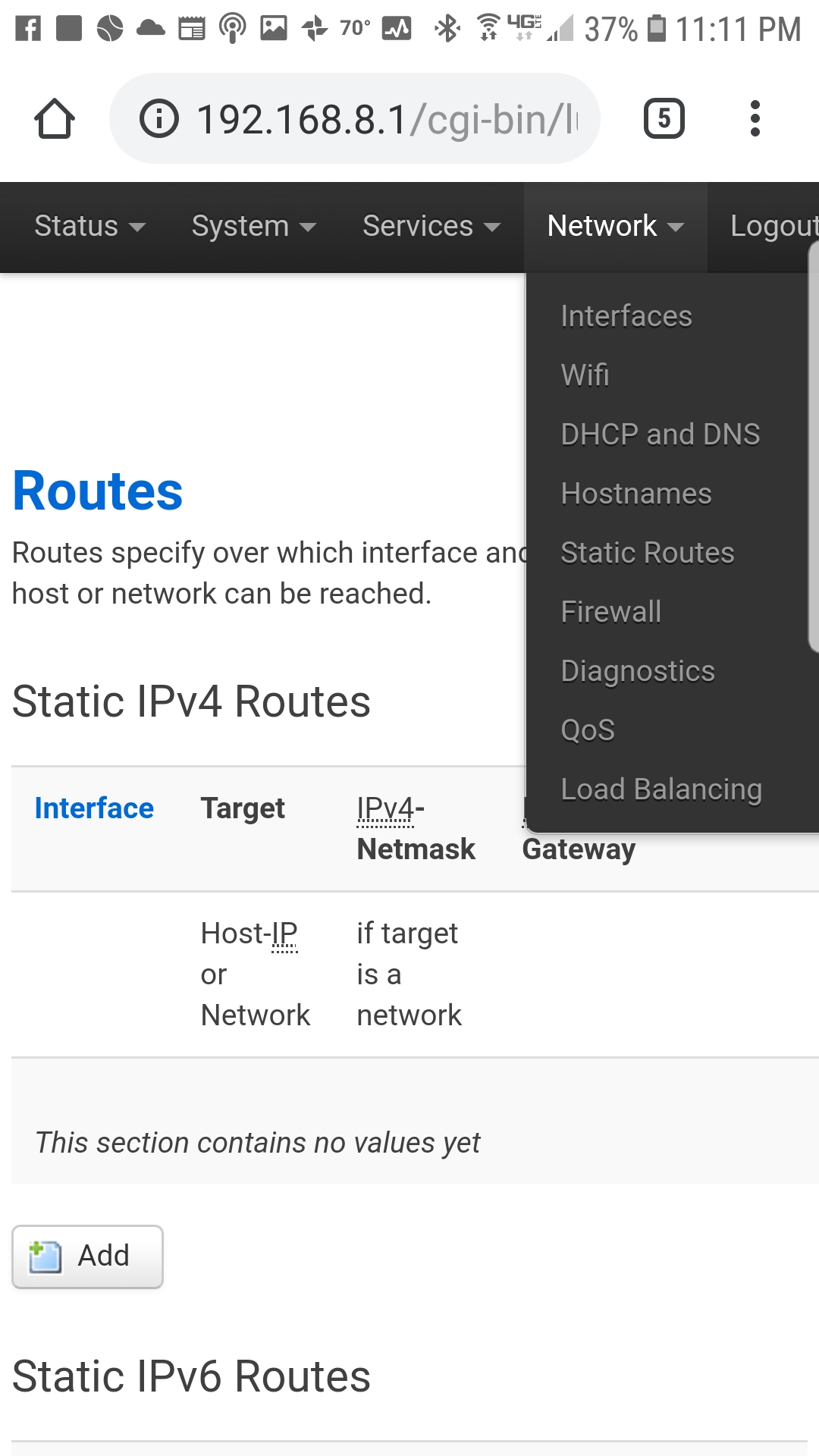

I have a screen that looks quite similar to the first one that you displayed, but I have no Network->Switch on my menu.
You need to get to the luci interface.
On firmware 3.x it’s Settings-Advanced but don’t know how on 2.x (can’t find doco). Try going to 192.168.8.1/cgi-bin/luci which may bring you to the luci screen. Just login with root and your normal password (sorry never used firmware 2. 0)
What happens if you click advanced settings top right?
(or as per the screen shot press the reset button for 10 seconds and hard reset so you can eliminate the config :grin:)
I’m into the Luci settings but I have no Network->Switch on my menu.
