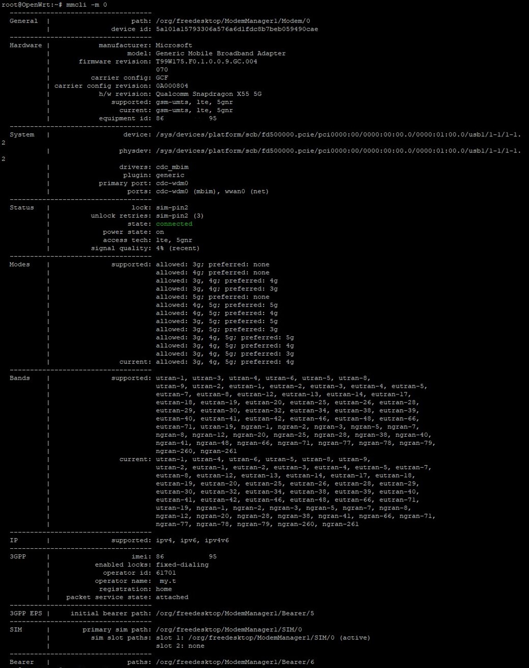

After all of this my mmcli looks like this:
Zrzut ekranu 2024-12-22 170825

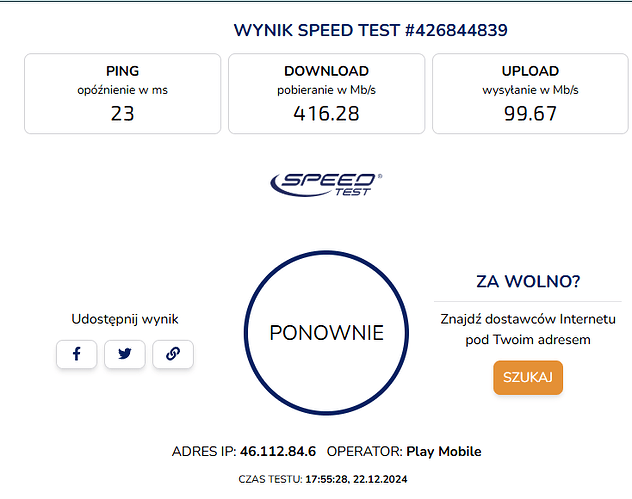

And speedtest with a 4G connection (didn't yet set proper allowed and preferred mode in mmcli)

At this point, there were no ttyUSB devices available, but the connection was working, and the modem was connected to my carrier as shown by mmcli (see bellow pic). So ModemManager probably uses MBIM to start the modem primary port: cdc-wdm0. This matches the OP’s pictures.
However, I wanted to change the current mode so that 5G would be the preferred mode. By default (same as the OP’s pictures), the modes were set to: allowed: 3g, 4g, 5g; preferred: 4g.
Unfortunately, ModemManager was not able to perform this action.
