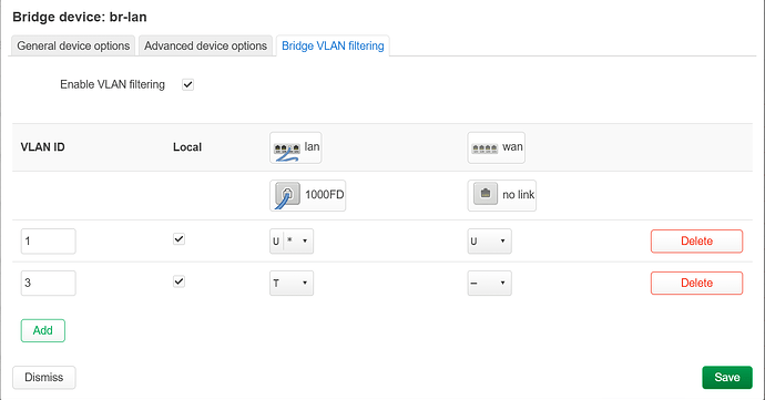

How I did it:
Connect AP directly to your PC
Set a static IP on your PC, in the same range as your AP
Open AP web interface
Configure VLANs
This is well documented online for OpenWrt-based APs.
Ultimately you want your AP bridge device to have VLANS configured similar to this:
