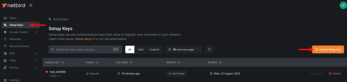

  1. Apply a SETUP_KEY from netbird, and copy it

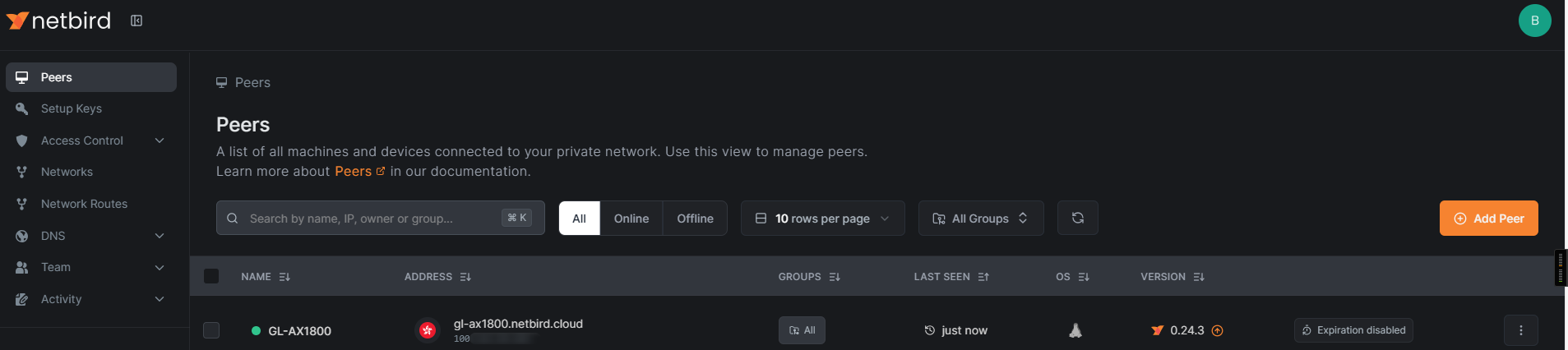

  1. Netbird dashboard shows the router is online:
-end
