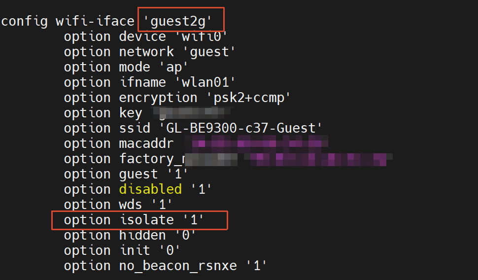

You can refer to the existing wireless interface configuration. Basically, you should add option isolate '1' under the corresponding wifi-iface section, at the same level as the SSID configuration:
