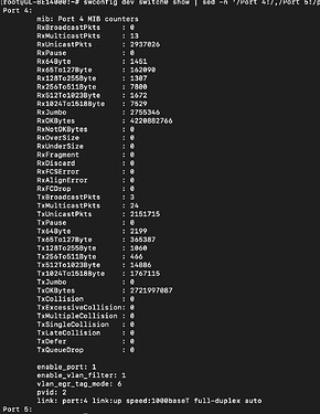

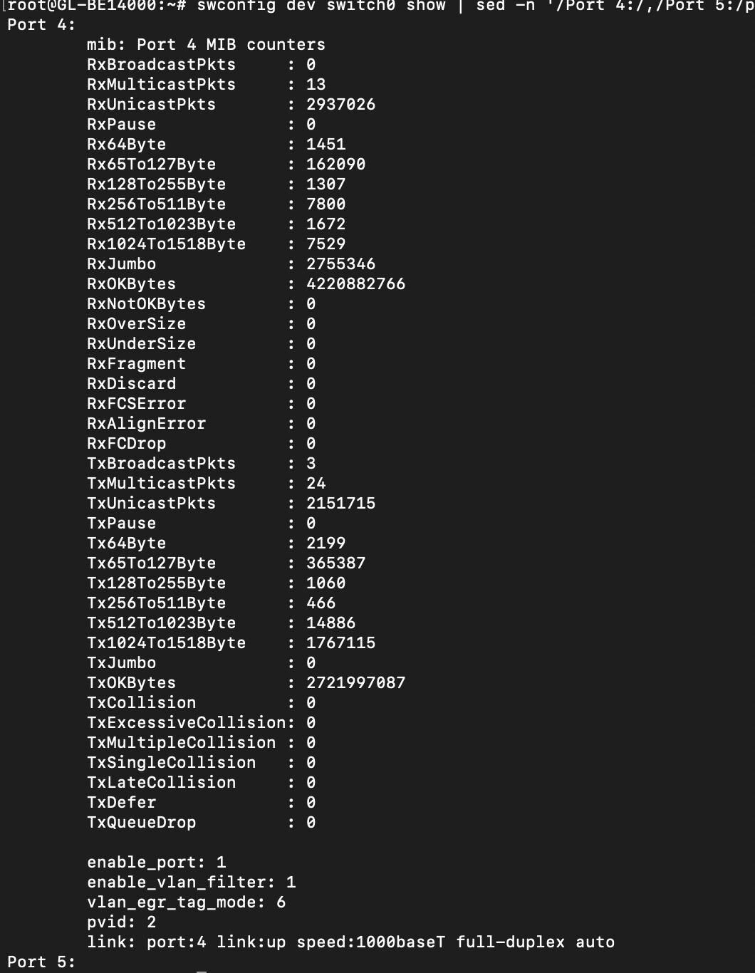

this is what I got after runing the cmd : swconfig dev switch0 show | sed -n '/Port 4:/,/Port 5:/p'
Thank you for the detailed information.
From the current results, the MA5671A can establish the connection successfully through the Flint 4 SFP+ port, but the SFP+ link is currently running at only 1 Gbps.
